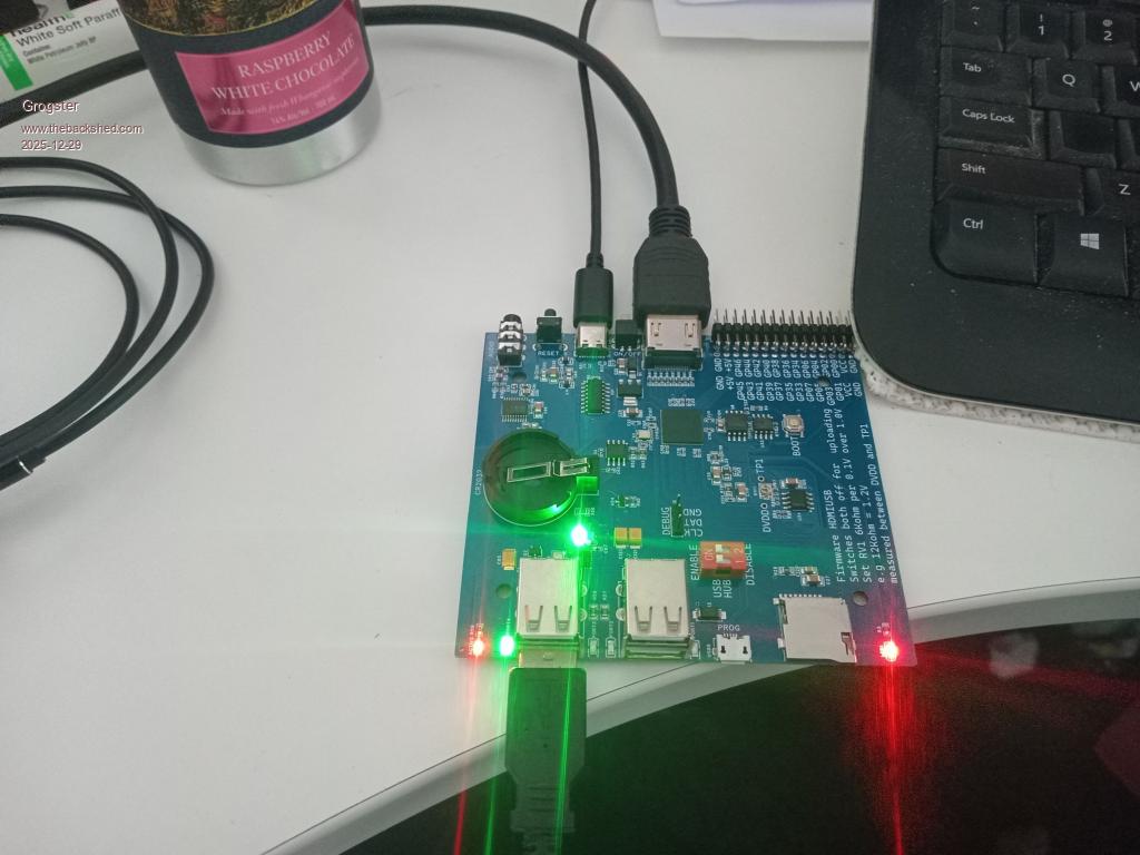

Very sexy!
Easy to setup, cheaper to produce then the CMM2G2v2(with no disrespect), and lovely feature-set.
I've only now had a chance to play with these, as up until now, I have been busy with work.
But now I am on my Christmas holiday, I can spend a bit of time, tinkering with things like this.
I have not yet tried out everything, but I must spew forth, my absoulute LOVE of the included audio DAC chip.  This is BRILLIANT, when hooked up to a good amplifier.
Again, no disrespect to the wonderful LPF on the CMM2 etc - Volhort did brilliant work there, but the fact is, that a dedicated DAC will always be better then PWM + LPF.
Four-port USB hub is an excellent idea, and with the HDMI video, this thing is just about perfect.  The only complaints you will get now, are those moaning that the audio is not on the HDMI port.....because people are never happy.
