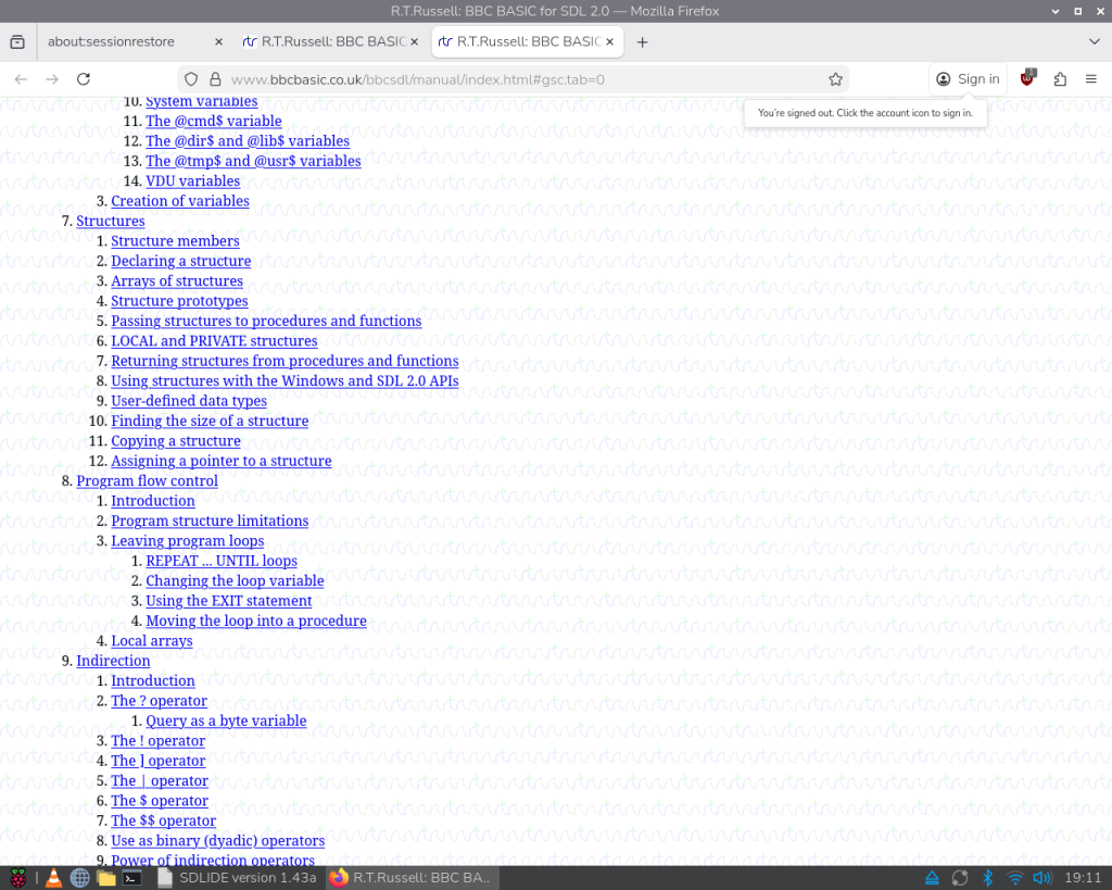

Posted: 07:16pm 29 Dec 2025
I looked up srtuctured coding/basic and the bbc basic I installed on rpi 400 has opengl and structures. Don't personally see the point but that's cos I don't know enough to say out.
Posted: 08:16pm 29 Dec 2025
I can get my head around "structured" basic ie simple flow with subs, no goto, but not structures. functions never used. I can't see any of this is would make any code I wrote better if I used structures.
