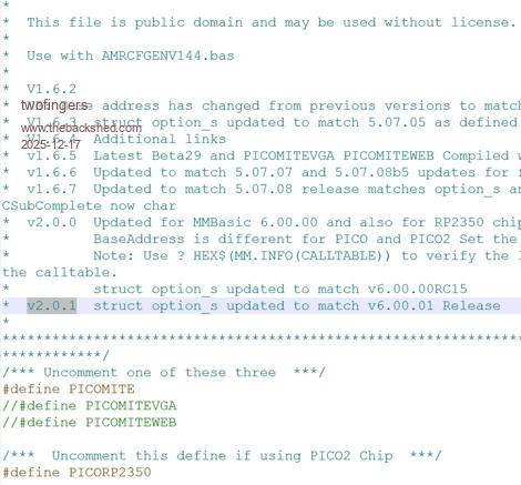

This is an up to date PicoCFunctions.h that covers both PICO and PICO2
v2.0.2  Calltable address now 0x1000023C for RP2350 v6.01.00 Release
PicoCFunctions.zip

Geoff. The PicoCFunctions.h above from Gerry (disco4now) should replace the one currently in the download
Edited 2025-12-17 23:06 by matherp
Posts: 3365
Posted: 03:01pm 17 Dec 2025
  matherp said  Geoff. The PicoCFunctions.h above from Gerry (disco4now) should replace the one currently in the download
OK.  The download has been updated.

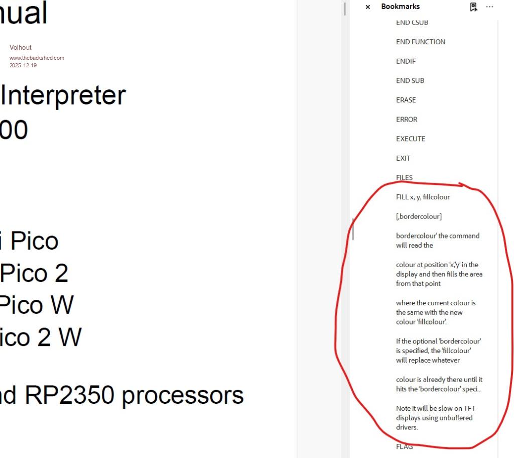

Geoff,
It may be just me, but I find the command list (in several places) is corrupted. Maybe you could confirm this is also shown at your original ? See below picture. This is the user manual that I just downloaded (19/12/25 13:00 CET).
Posts: 4372
Posted: 12:46pm 19 Dec 2025
Seems OK to me, though file shows as
Dec 18 20:54 PicoMite_User_Manual.pdf
GMT here.
Edited 2025-12-19 22:46 by JohnS

Command list also corrupted in my user manual. Dated/downloaded 16.12.2025.
