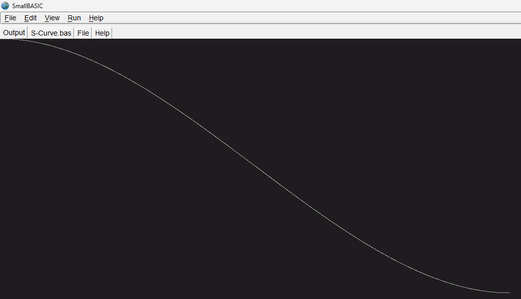

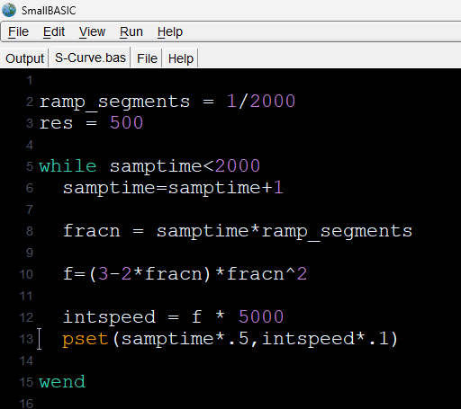

This is the most efficient s-curve that I have come across:
I have it in SmallBasic here:
