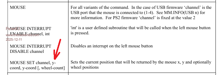

Posts: 6049
Posted: 10:54am 11 Dec 2025
Hi Geoff,
Typo : the "a,b,v,d" should be "a,b,c,d"
Bleep
