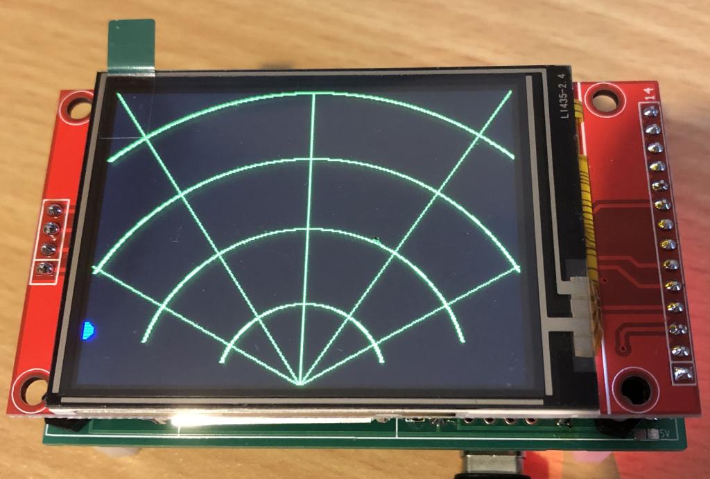

Now I've bought four more displays from AliExpress, which also use the ILI9341 display driver. They look like the display I'm currently using. However, it appears they're using portrait mode, even though landscape is selected. The small red dot on the left side of the display in the radar grid isn't red, as it should be, but blue.
I've tried all the available settings for the ILI9341 (L, P, RL, RP). The display rotates, but it's not using the full 320 x 240 pixels. It looks like it's using 0-240 for X and 0-320 for Y.
Does anyone have any suggestions on how I can use this display with a different setting?

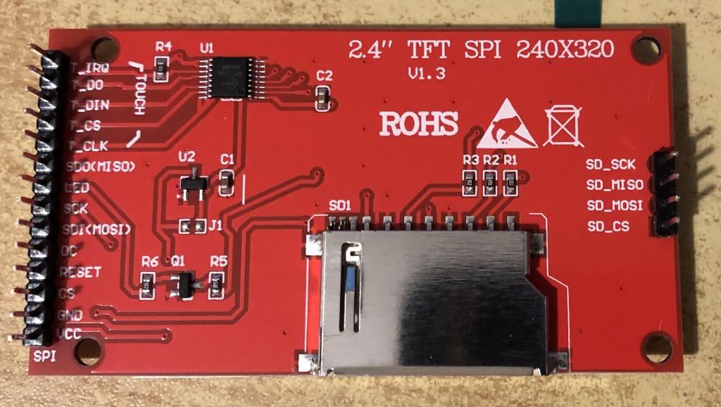

Backside of the "good" ones.

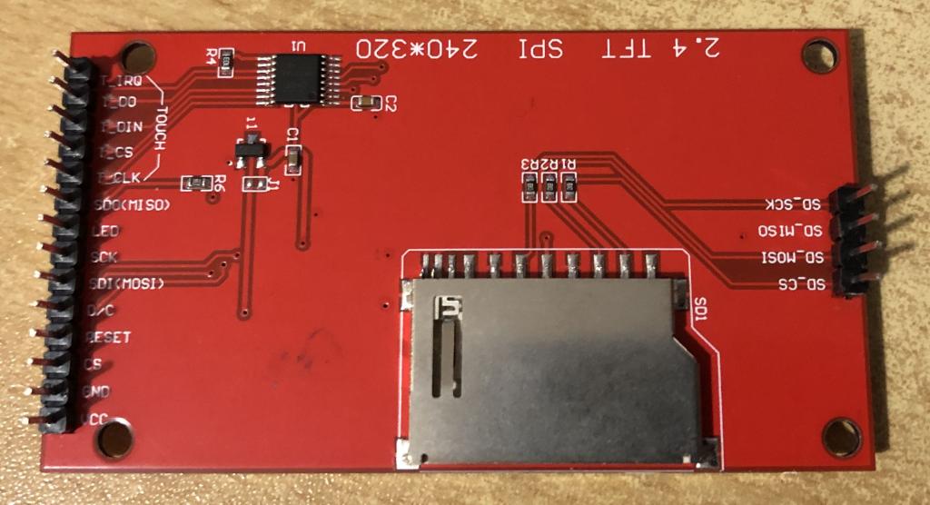

Backside of the "bad" ones.

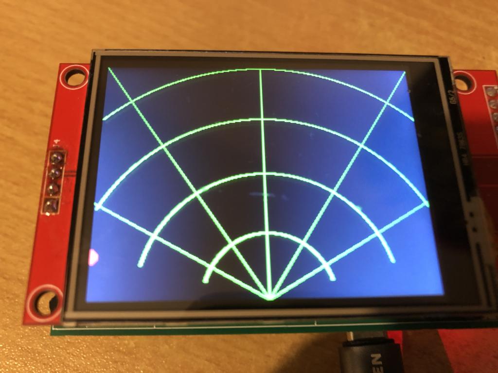

Thank you for the information. I managed to make the display now look the same as the other displays. When setting the option for the LCD, I entered "RP" as the orientation and in the program
poke display hres 320
poke display vres 240
When I want to append "INVERT" to the LCD OPTION, I get an error (PIN 0/NULL). It worked with a fantasy GPIO, but all colors were inverted. The blue dot became yellow and the actually correct green lines were also inverted. But you can set that with LINE and CIRCLE. That's not a problem.

Following a tip I found online that AliExpress was selling displays with the wrong driver (for example here https://lecity.edu.au/?p=2761), I entered this option:
`OPTION LCDPANEL ST7789, LANDSCAPE,GP7,GP2,GP5,,INVERT`. Now all the colors are correct!
Together with `poke display hres 320` and `poke display vres 240`, the orientation is also correct.
Edited 2025-12-06 08:31 by v.lenzer

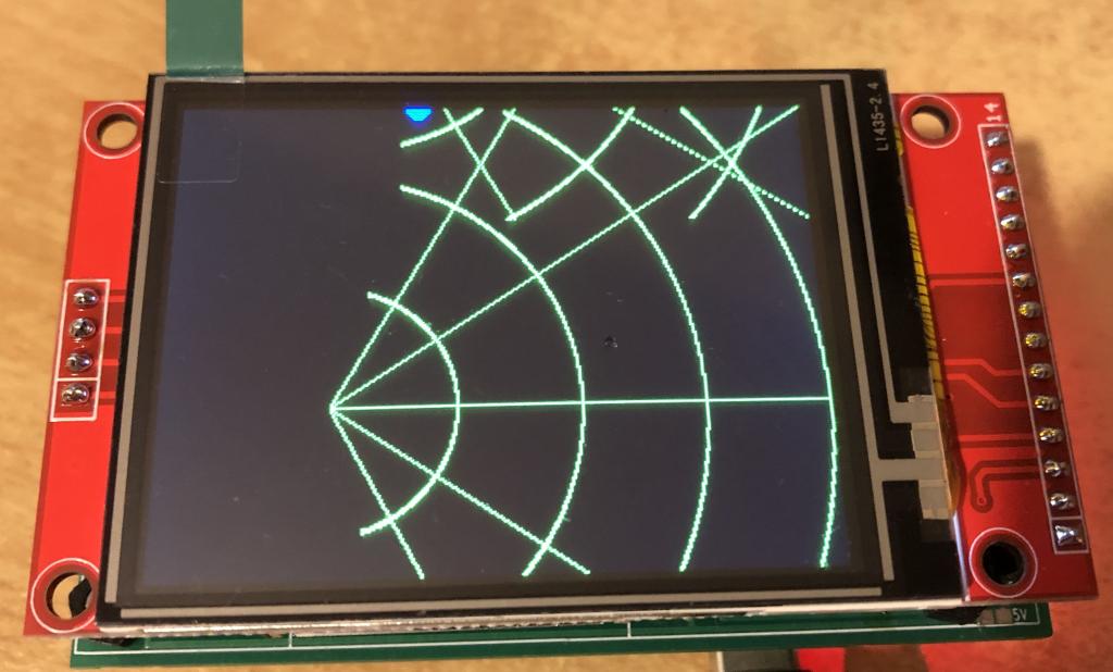

This solved the color problem. BUT: now X0/Y0 is no longer in the upper left corner, but in the upper right corner. I don't understand it, but that's how it is.
This is the entire program. Please note that this was only intended to help understanding the graphics commands. It has nothing to do with the radar program. I think there's a simpler way to convert from polar coordinates to Cartesian coordinates.

I got displays with the ST7789 from Aliexpress. If you look at the pictures of this Offer  or here in this post , then you can see what the ST7789 displays look like on the back. And I have one exactly like that.
I'll continue to try out your suggestions later today. Maybe a good solution will be found so that I or a future colleague can still use this display.

poke display &H36, &H08
Landscape, color correct except for the blue instead of red dot,
Alignment correct, X0/Y0 in the upper right.
poke display &H36, &H80
Everything is correct!
poke display &H36, &H88
Landscape, color correct except for the blue dot instead of red,
Alignment correct, X0/Y0 top left.
Conclusion: To work with these displays, the values ​​&H36 and &H80 must be set.
Best wishes! Joachim
