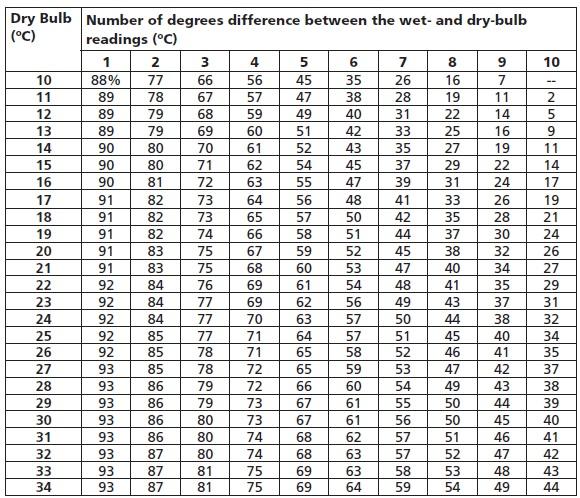

Can anyone point me to Psychrometric Tables, in table form not a graph, in Celcius. All I can find are tables in Fahrenheit. I asked AI and got all sorts of rubbish.

Here is one I found . Only goes up to 40°C so you may have to extrapolate when it gets hot.
relative-humidity-table.zip

palcal
Joined: 12/10/2011
Posts: 2053
Posted: 03:03am 30 Nov 2025
Thanks Jim, that's ok for now.
