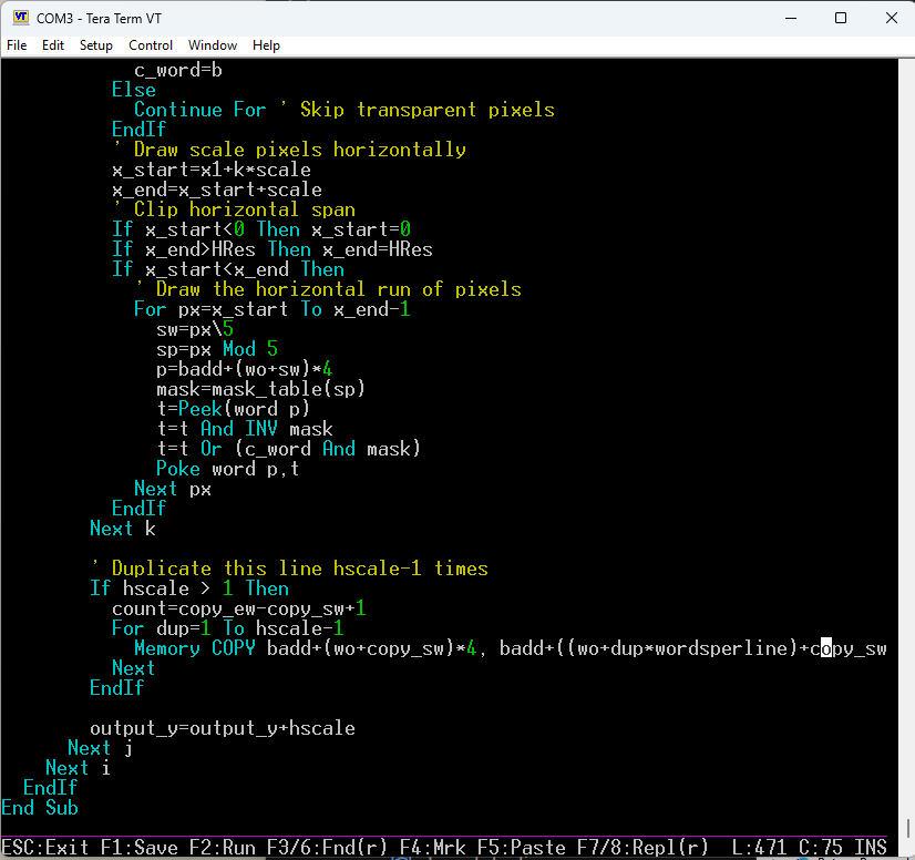

Posts: 6049
Posted: 08:33am 28 Nov 2025
@Peter,
Works nice.
But my Alzheimer comes into play. In het help line, only F1..F5 are shown, and next week I will have forgotten if F7 or F6 or F8 have what function. Is there a way to adjust the help text.
Posts: 11782
Posted: 10:06am 28 Nov 2025
I think this is the best I can do. Leaves one space for lines above 1000 or column >100
Posts: 6049
Posted: 10:28am 28 Nov 2025
Hi Peter,
Looks good. Maybe :
ESC:Exit F1:Save F2:Run F3/6:Find/r F4:Mark F5:Paste F7/8:Repl/r  L:471 C:75 INS
Replace the "()" with a "/" save 2 characters you can use for the i in Find, and a in Mark.
Edited 2025-11-28 20:30 by Volhout
