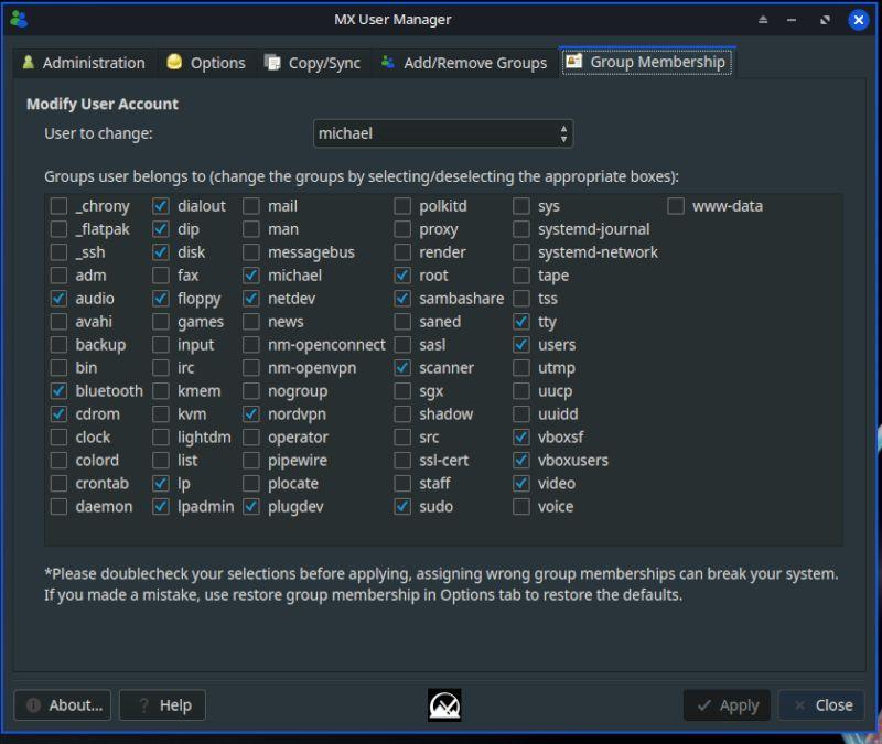

What version of Arduino IDE are you downloading. I'm using the V2 Appimage from Arduino web site:
arduino-ide_2.3.6_Linux_64bit.AppImage.From https://www.arduino.cc/en/software/]
Arduino site has Appimage install info.
FYI: Linux MX-25 XFCE
Desktop: Xfce v: 4.20.1 tk: Gtk v: 3.24.48 wm: xfwm4 v: 4.20.0 with: xfce4-panel
tools: xfce4-screensaver vt: 7 dm: LightDM v: 1.32.0 Distro:
MX-25_Xfce_ahs_sysvinit_x64 Infinity Nov 9 2025 base: Debian GNU/Linux 13 (trixie)
Very low CPU and RAM usage.
Menu -> MX Tools -> User Manager -> Group Membership:

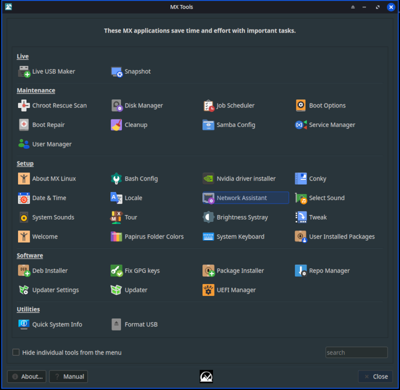

FYI: This is the MX tools available, there dozens of others, things like Timeshift etc are all there.

Hi Keepis I have the same version of the Arduino software and for a laugh just booted up the laptop and used your tips above so I could setup my username and saw that the dialout was already assigned so fired up the Arduino software and the nano connected straight away. I did have to change to the old programmer and for a laugh loaded the screen to to the nano and as the leds on the nano did flash it did program
