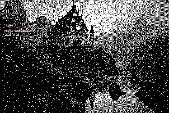

Here’s a small video of the game I mentioned in my previous post.
Ravenloft youtube preview
When I see the quality of other games, I don’t even dare share the code for the current state of mine. I’m currently refining the code I wrote with Mistral AI (go France!) and ChatGPT to build a proper game engine. i'm a total beginner and made absolute spaghetti code.

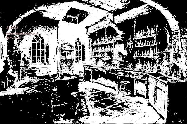

I’m not posting this to show off the current state of the game, but because I have a problem.

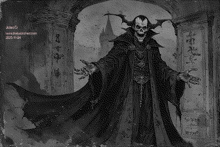

I used to use a software on Windows (I think, though I also use Linux a lot) that could convert BMP files into images like the ones I was producing at the beginning of the game. However, I lost my development machine along the way and can’t remember the name of that software...
Before :
After :
The BMP files I created with AI and then processed in GIMP don’t look anything alike the one I did with the previous software... I really liked that "dot" effect.
Do you know which software did that, or what filter/post-processing I should use in GIMP to get the same result?

Your second image is not attempting to do any dithering, whereas the first image is.
So I think you need the original picture in colour or shades of grey, then use a program to convert it to a 2 colour image, black and white, but using dithering to reproduce the shades of grey.
Have a look at this thread these were dithering for colour images, but as I said, just specify only a 2 colour image as output.

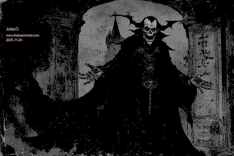

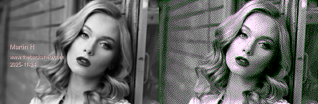

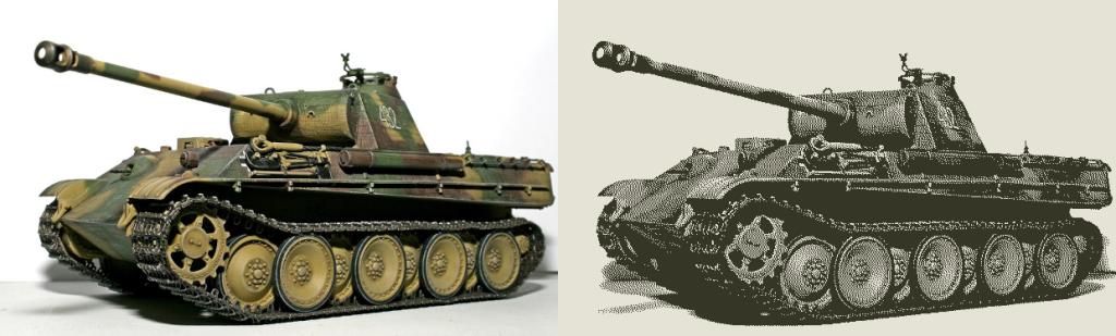

The Picomite VGA does not have a color for gray, but it is still possible to dither and display grayscale images reasonably well.So it's all about mixing colors
On the left is the original image, on the right is the image prepared for the Pico.
The conversion program runs in MMBasic for Windows.:

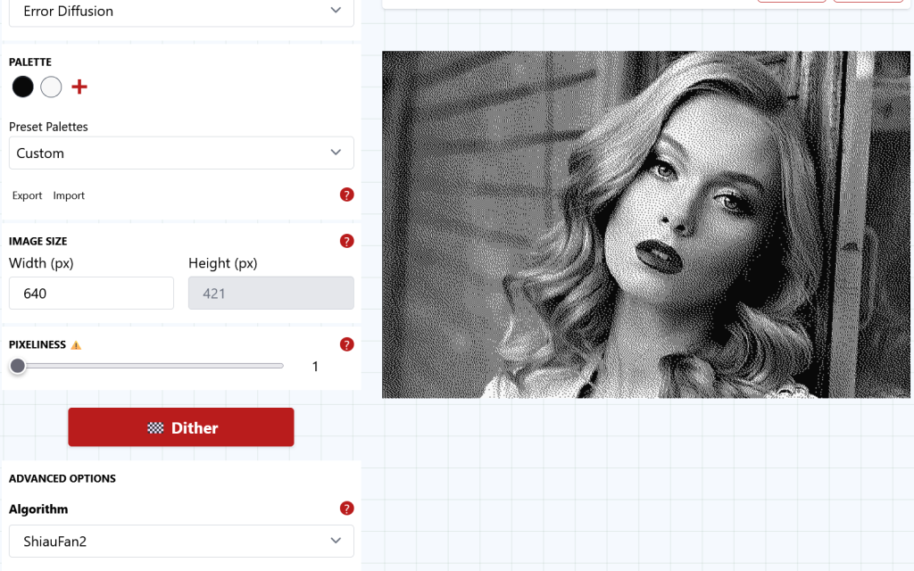

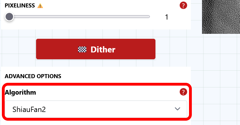

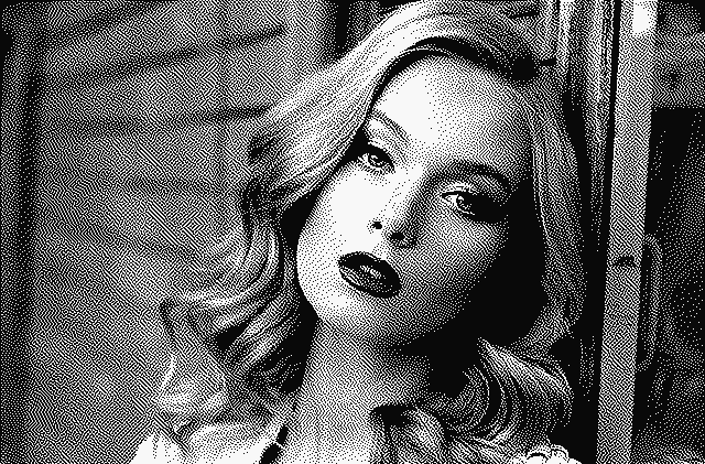

if you want it Mode 1 (B/W) maybe you try https://ditherit.com/
upload your Grayscale Picture, remove all Graytones exept Black and White, then let it dither it for you
Have Fun

then if you want it Mode 1 (B/W) maybe you try https://ditherit.com/
remove all Graytones from the color Palette (exept Black and White),
Edited 2025-11-24 00:46 by Martin H.

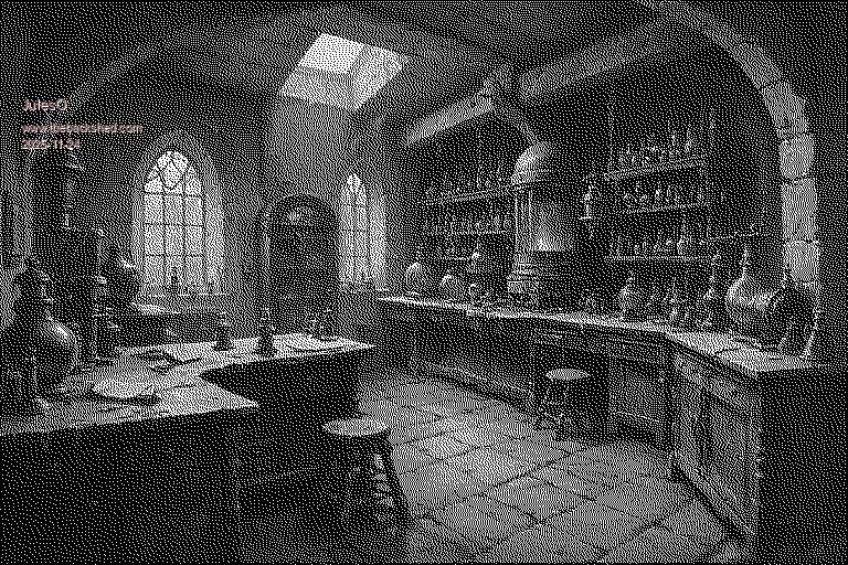

  Martin H. said  then if you want it Mode 1 (B/W) maybe you try https://ditherit.com/
Martin this is it !
I used to ask AI to make me a jpeg.
Then i was greyscalling it using gimp and used my software to do the dithering.
This website is exactly what I was looking for.
Again thanks a lot to you and this amazing community, i'm back to work !

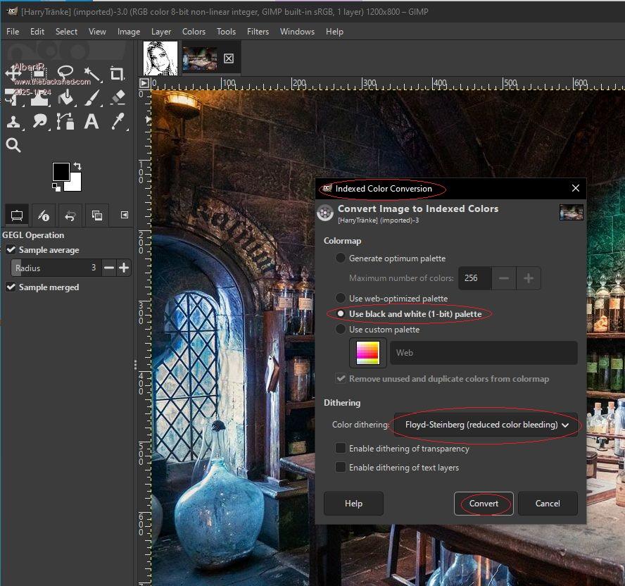

Hi Jules,
it's great to see how many solutions there are.

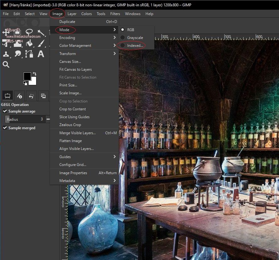

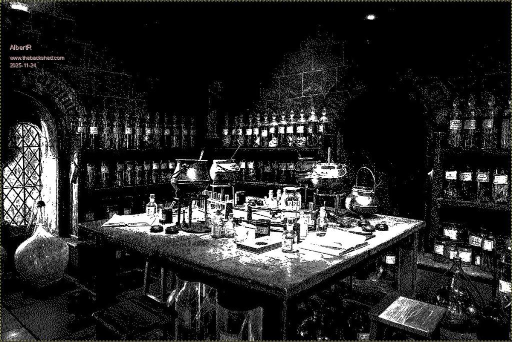

Thanks a lot, I was playing with Gimp with no success, i'm trying this.
I think I need to defend GIMP's honor here.
With procedure
you got thomething like this
Albert

I was sure it was possible...
Gimp always amaze me but like linux you got to understand it before. Thanks a lot, AGAIN !
EDIT : it look very nice, there's some job to do with contrast
It's really good
EDIT EDIT : with indexed colors as you shown
It's really nice

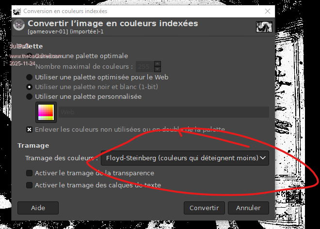

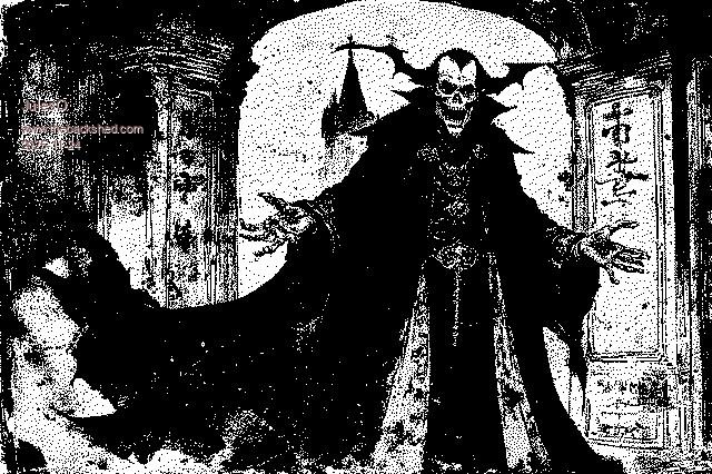

Hi Jules,
You can do it with Gimp.
1. Load your color image and scale it to the desired size
2. Change the mode of the picture to "Indexed"
3. Select "optimzed palette" wit 2 colors only
4. Activate Floyd-Steinberg dithering,
  "Dithering for transparency" could be helpful as well.
The result will look like this:
Have fun
 Matthias

thanks everyone.
As said by @AlbertR one got to choose reduceed color bleeding to achieve
better color result.
In french in case a fellow is here :
Edited 2025-11-24 03:54 by JulesO
Martin H.
Joined: 04/06/2022
Posts: 1573
Posted: 09:10pm 23 Nov 2025
This depends on the source image. You can choose from various algorithms for this purpose.
'no comment
