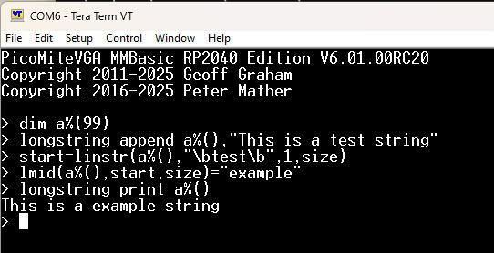

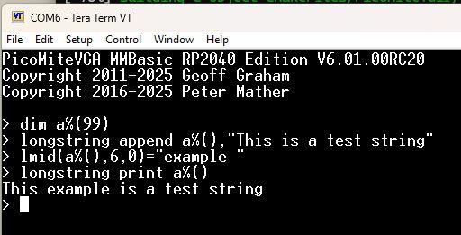

Attached re-worked C code and header for a comprehensive regular expression support for MMBasic. Support for this code will be in RC19 for the PicoMite when released. I'll leave it to Gerry to include in CMM2 and update the documentation.
re.zip
This includes pretty comprehensive support for groups other than Anchors inside groups. I've also added word boundary support \b and \B. Below is the test script for this functionality. For me on a RP2040 VGA version this passes all test 100%

Posts: 12057
Posted: 06:18pm 23 Nov 2025
Don't understand the question. The syntax is:
LINSTR(array%(), search$ [,start] [,size]))
  Quote  Returns the position of a search string in a long string.
The returned value is an integer and will be zero if the substring cannot be
found. ‘array%()’ is the string to be searched and must be a long string
variable. ‘search$’ is the substring to look for and it must be a normal
MMBasic string or expression (not a long string). The search is case sensitive.
Normally the search will start at the first character in ' array%()' but the
optional third parameter allows the start position of the search to be specified.
If the optional parameter ‘size’ is specified the ‘search$’ is treated as a regular
expression.
The idea of start is that you can iterate through the line finding all occurrences by positioning it after what is found using the return position and the size
LeoNicolas
Joined: 07/10/2020
Posts: 625
Posted: 06:48pm 23 Nov 2025
Thank you Peter for including this feature. I love regex, they are great to create complex text searches using simple regex patterns. I've been using them for at least 20 years
Posts: 12057
Posted: 07:39pm 23 Nov 2025
  Quote  Thank you Peter for including this feature.
In RC20 I will also include an new command LMID this is the longstring equivalent of MID$. This will allow you to have a large text file in a longstring and with a combination of LINSTR and LMID be able to edit it in quite a powerful way.
