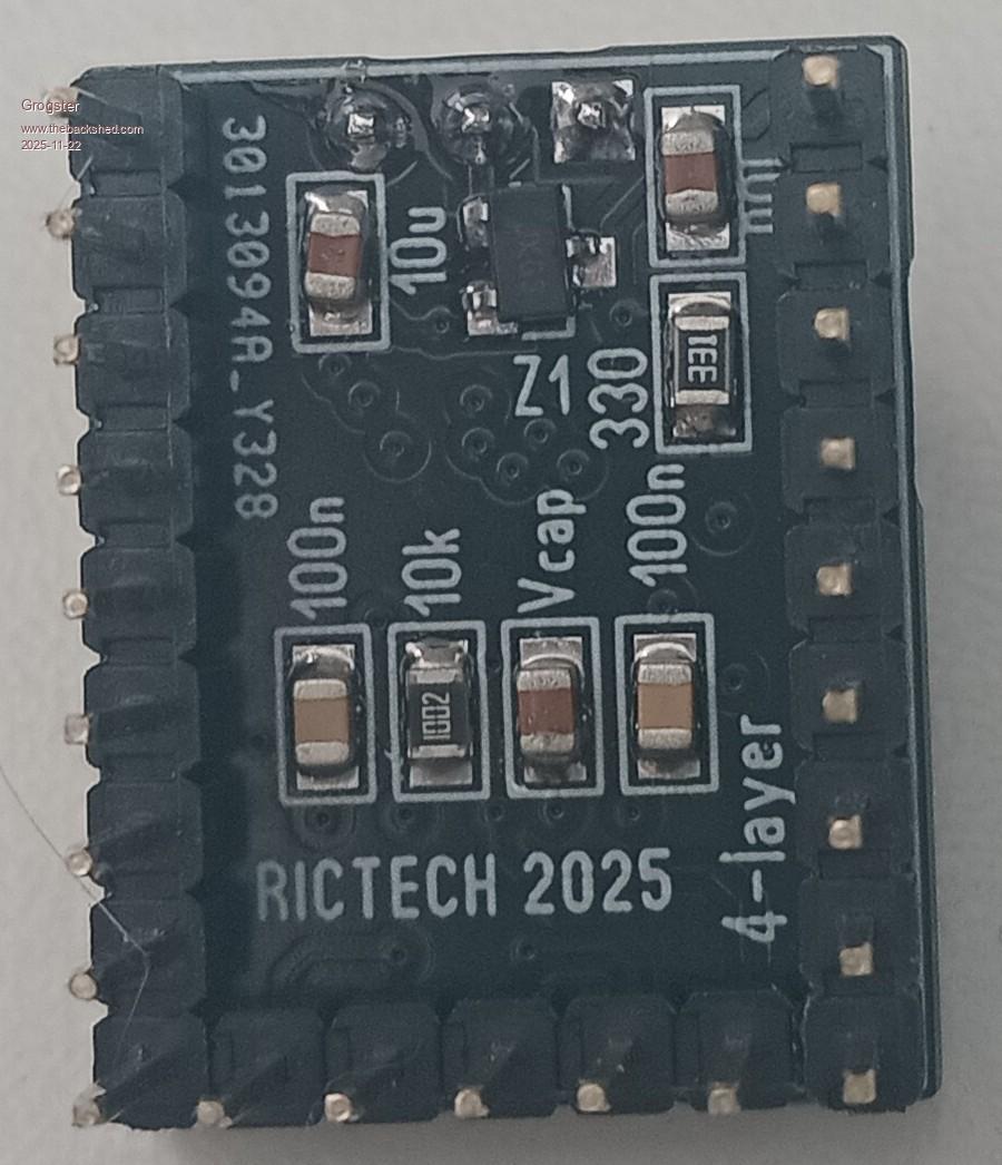

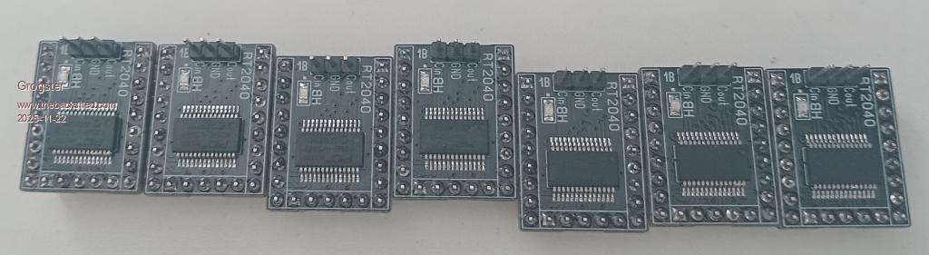

Yes, they are.
Well spotted.
I'm still having issues with the WS-Zero modules, even WITH the NORESET option, they are still crashing for reasons I have no idea why.
The NORESET option does not seem to help - they just stay in the crashed state until I cycle the power to them.  The blinking 2812 LED I put in the last WS-Zero code to act as a heartbeat, has stopped - they are no longer blinking when I remove them from the wall.
So, time to back-peddle a little, and go back to the single-task PIC32 chips, as I have never had any issues with any units based on those chips, ever locking up.  Ever.  They are rock-solid, once you have bug-free code.
I've already ported the code from the Zero, over to the new RT2040 module and have one running on the bench.
I now also have a reflow oven, a hot-plate and a hot-air rework station, so I can mass-produce these boards with little effort or time spent.
As to your question, I was not planning on putting them up on my website, as it was more a specific design to do a specific task for a specific need and a specific problem.
Specifically.
But if you want any, I can certainly rustle up a couple, that's not a problem.
If anyone else reading this thread, thinks they could be useful for them also, let me know here, and if I get any interest, I can put them up on my website.
They would cost more then the WS-Zero though, cos the price of the PIC32 chip alone, is more then the $5 cost of the entire WS-Zero module!

HOTPLATE...
HOT-AIR REWORK STATION...
SMD OVEN...
The oven is the 962A - the latest version, that incorporates changes and suggestions made by many people who bought the first gen oven.  Specifically, the "A" version has a heat-blanket-insulation-thing installed around the inside of the internal of the oven, rather then the standard insulation and masking-tape of the first gen units - that used to burn that tape and make an awrful smell.  The new unit also has a better controller and more accurate thermal profile, and the fan at the rear is also now baffled.
As far as the hotplate, I set that to 155'C, and preheat any PCB first, and then attack it with the hot-air station set to 220'C, airflow set to #2.  I can solder eight or so of the RT2040 PCB's in about 90 seconds once pre-heating has completed, and I attack them with the hot-air wand.
The components MOSTLY self-align as you would expect once the solder-paste flows, but I have had the odd cap misbehave during the first pass.  To correct, just apply more hot-air, and give the cap a wee poke with the end of my tweezers(keeping my hand OFF the hot-plate!), and it re-self-aligns and reflows - visual thing of beauty to behold.
