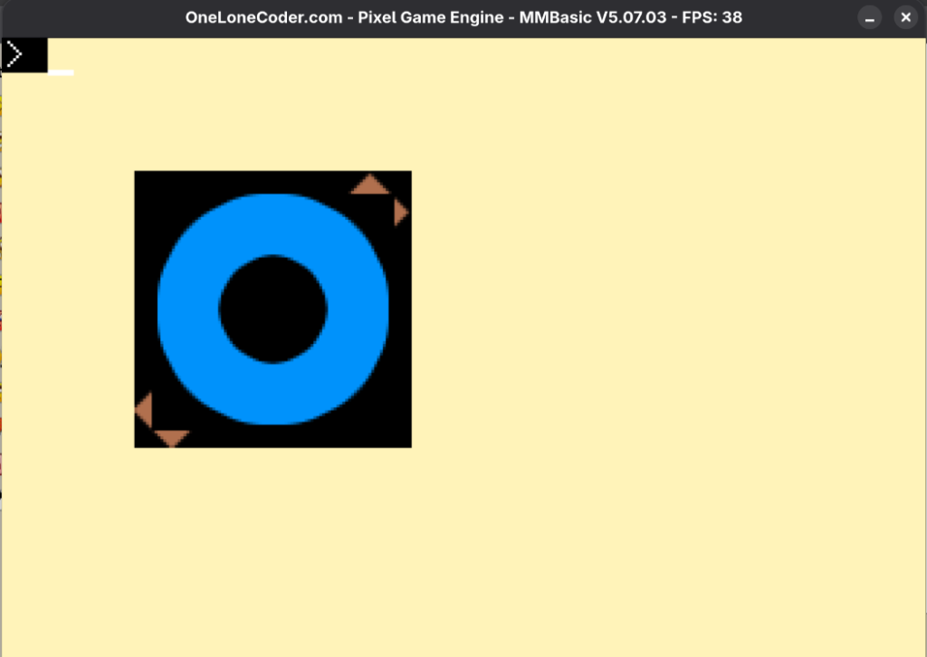

the result is:
The transparent areas from the PNG are copied as black by the blit command, overwriting the back image and background.

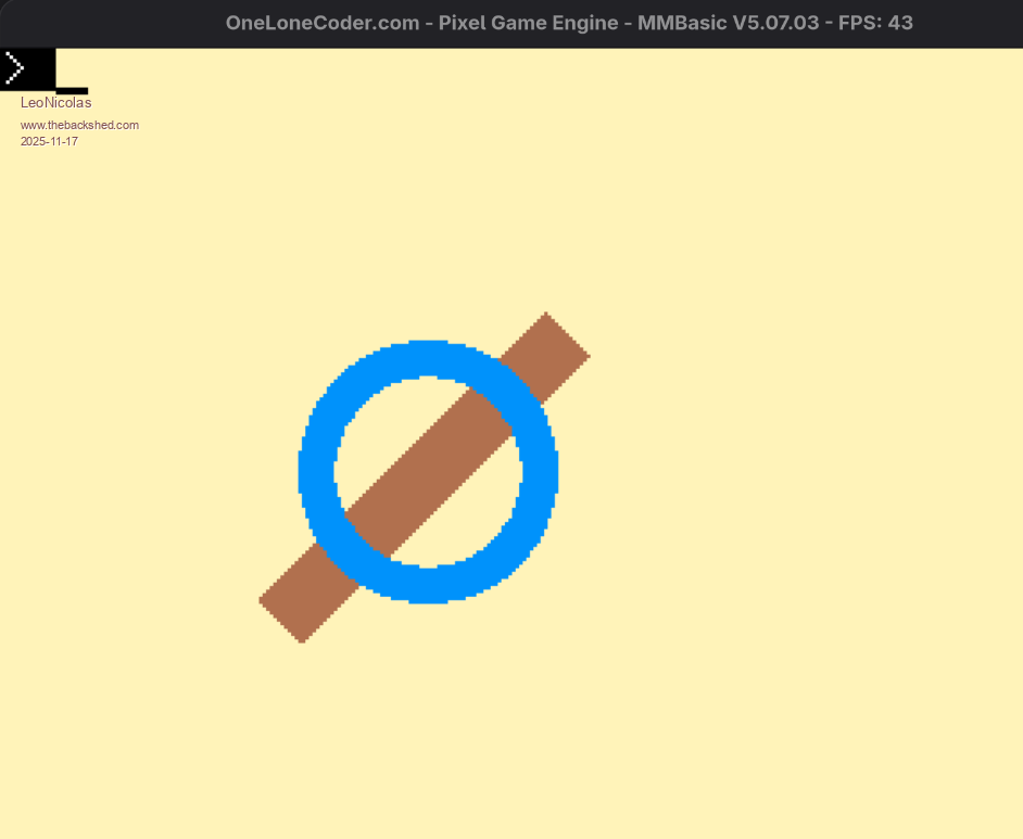

I found the solution. I can use the sprite write command to copy the pixels like a blit command, but respecting the transparency.
option explicit
page write 1: cls 0
page write 0: cls rgb(255, 243, 185)
mode 7,12,rgb(255, 243, 185) ' 320x240 / 12 bits
page write 2: cls 0
load png "test.png",,,0
sprite read 1,82,0,100,100,2
sprite read 2, 0,0,74,74,2
page write 0
sprite write 1,72,72
sprite write 2,84,82
And this is the result:

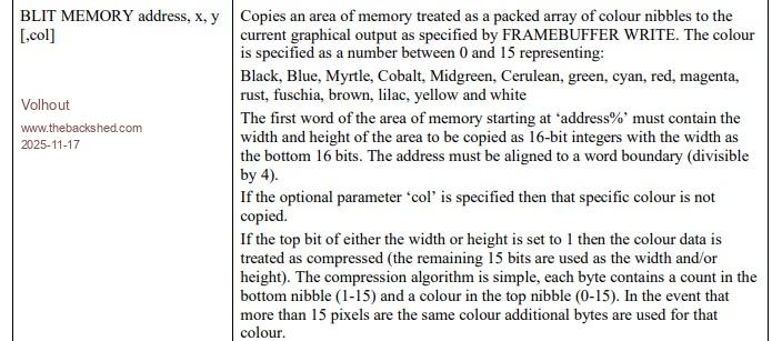

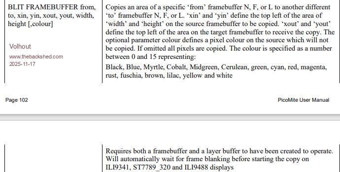

On picomite(VGA) there are typical only 2 layers. The N layer is on bottom, and has no transparency. The L layer is projected onto N, and knows 1 color of transparency.
Following BLIT commands are omitting the transparency color.
I think there will be a lot of commonality with CMM2, since Petscii Robots uses them, and this game is made to run on CMM2 by Peter.

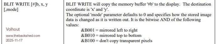

Look at the "orientation" parameter in the BLIT command.
Also, look for the "NOTBLACK" colour.
