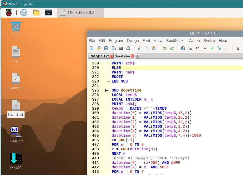

The usual recommendation is to do a clean install and then reinstall your applications.
I decided to try an in-place upgrade.
I do have a working bookworm safely stored away "just in case"
I followed the instructions here:
https://forums.raspberrypi.com/viewtopic.php?t=392376
I don't use a monitor on my RPi's and my usual tigerVNC from the main PC was used.
The only programs of interest in the experiment were MMEdit and PureBasic which I use  to compile MMEdit.
Everything still works!
Next I will try compiling a new version of MMEdit on the trixie image and check that it still works.
If successful and anyone is interested, I may offer MMEdit for RPi.
There are a few annoying "features" of Wayland but that's life.
