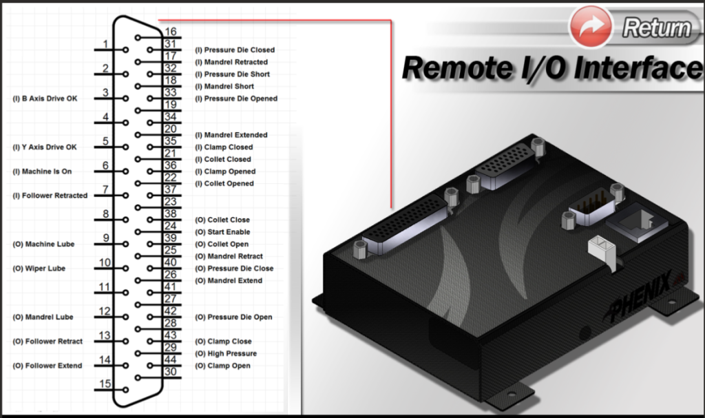

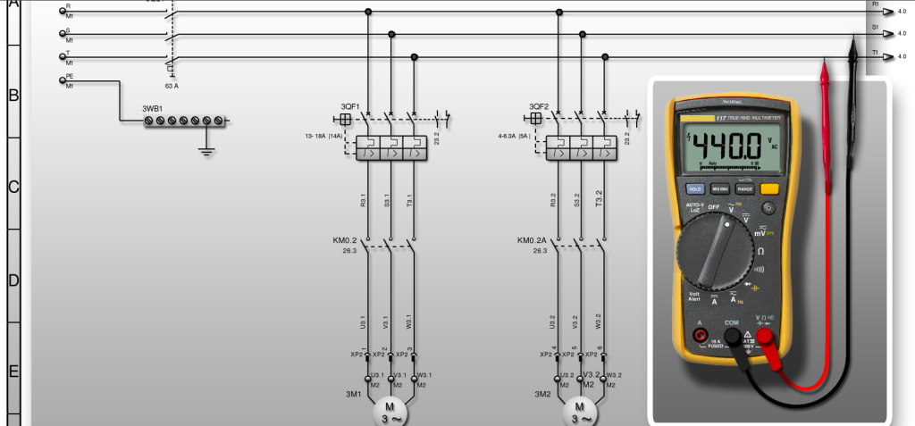

Another pet peeve of mine. I received a call about a machine that I was only vaguely familiar with and it had a Windows front end. "We are getting Error 0315, do you have any idea what this means?"
Are you kidding me...A full-blown computer that only provides error numbers that you need to look-up in the user manual (that can never be found)
Imagine a simple embedded application that only requires a PicoMite HDMI/USB.
The maintenance tech being able to connect a monitor, keyboard, mouse and getting a full description of the machine fault, suggested troubleshooting procedure, schematics, spare parts list, including sources.
And informative images such as:
No messing around finding that old XP laptop with the valid programming license and that proprietary RS485 cable with the obscure connector to interrogate some obsolete controller.
Possibilities are endless

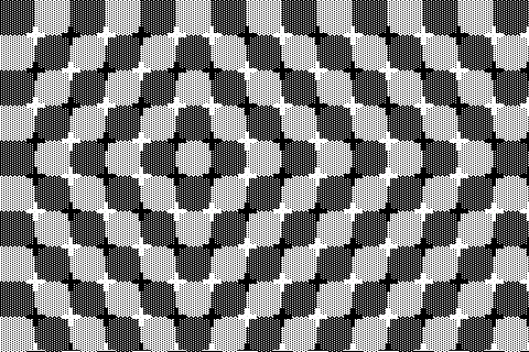

Posted: 06:35pm 11 Nov 2025
> save "distortion.bas"
> run
A:/distortion.bas 11-11-2025 14:37:22
> list
' distortion.bas
Print MM.Info(current);" ";Date$;" ";Time$
CLS
For y=0 To MM.VRES Step 2
For x=0 To MM.HRES Step 32
  If (x And 32)Xor(y And 32) Then
    GUI Bitmap x,y,&hBBBBBBBBEEEEEEEE,32,2
  Else
    GUI Bitmap x,y,&h4444444411111111,32,2
Next
Next
For y=1 To 14
For x=1 To 19
  c=(x+y+(x>5)+(x>14)+(y>4)+(y>11)+1)Mod 2
'   Line 32*x-8,32*y-2,32*x+8,32*y-2,4,c
'   Line 32*x-2,32*y-8,32*x-2,32*y+8,4,c
  Line 32*x-8,32*y-2,32*x+8,32*y-2,4,Choice(c,&HFFFFFF,0)
  Line 32*x-2,32*y-8,32*x-2,32*y+8,4,Choice(c,&HFFFFFF,0)
Next
Next
Edited 2025-11-12 04:46 by lizby
