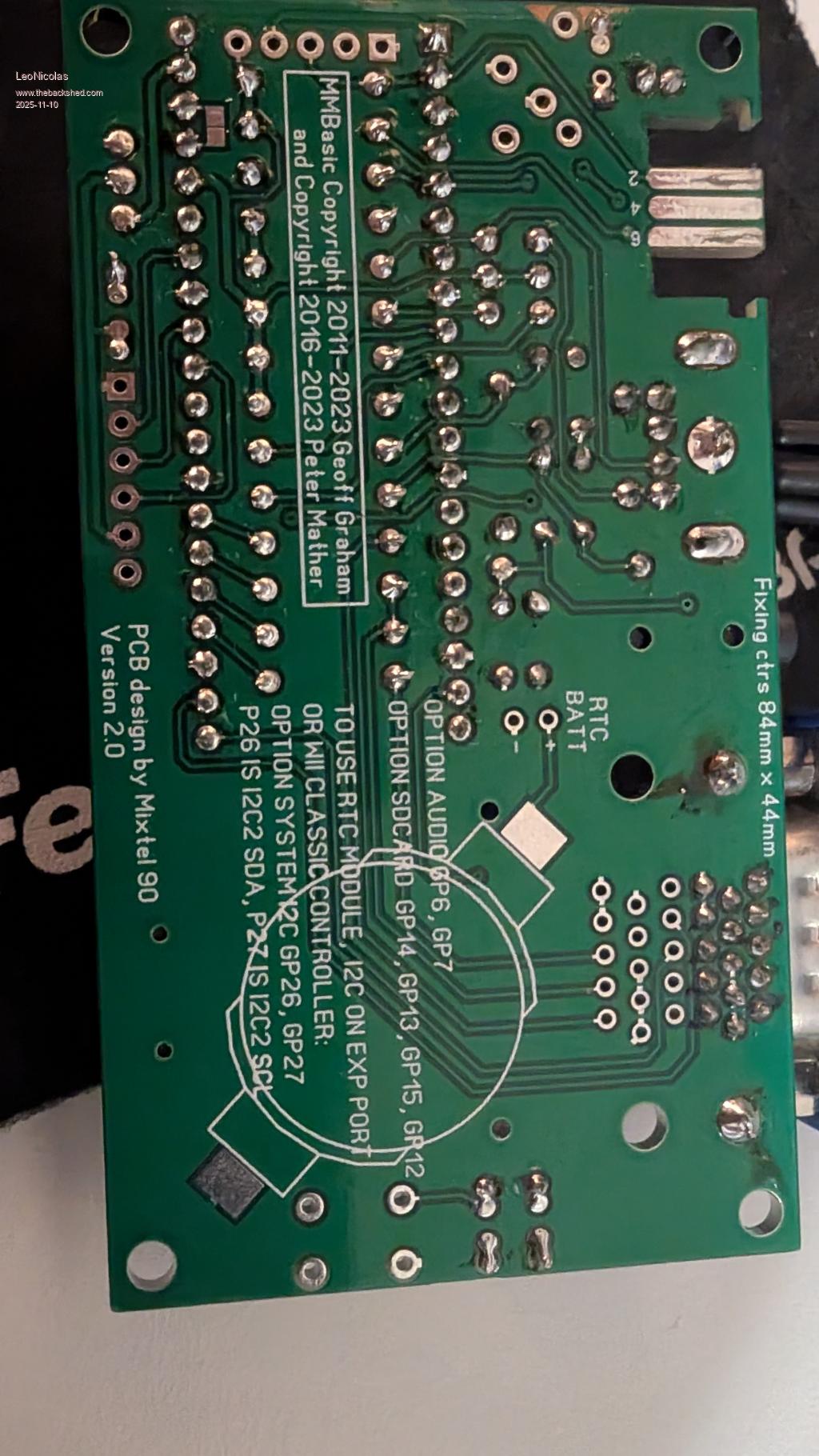

This is the photo of my board:

Type OPTION LIST
Is there an option sd card ?
Check if the option settings are the same as in the document that came with the unit. Maybe your current setting are mismatch of pins.

Never mind, it is written on the back of the board

I recognize that board from somewhere... :)

Thank you very much for writing the command at the back of the board. It was super useful.
