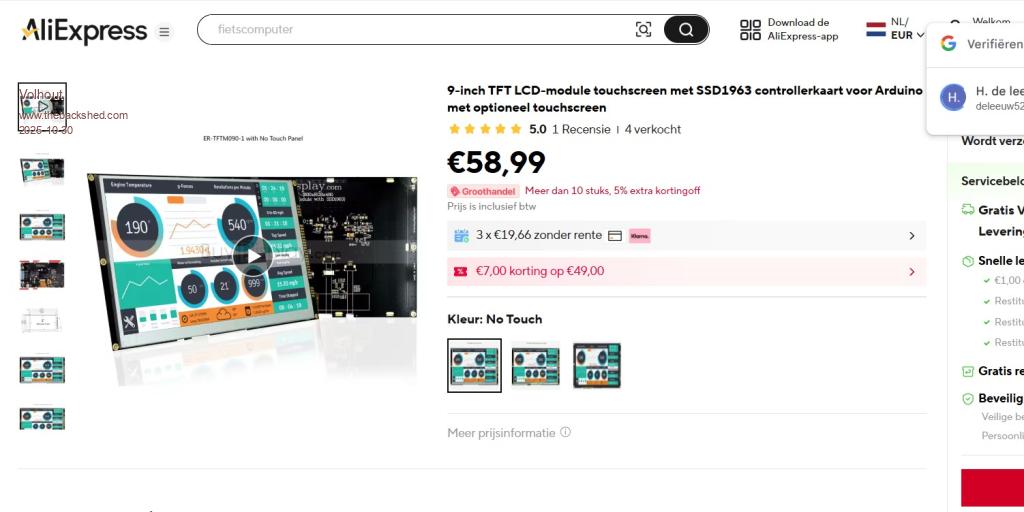

Maybe this works.
Very likely these  work
Take care that you choose one with a supported touch controller. The XT2046 should do I think, maybe someone knows better.

Personally I'd pick the largest *supported* version from the manual. I like to play safe though. :)

These Waveshare 10" DVI screens offer a very affordable HDMI display at £26.35 currently (plus shipping) PR but unfortunately they have no 'touch' ability if that requirment is really essential to you.
https://www.waveshare.com/pico-dvi.htm?sku=25510
They work very well with Mick's Pico2 adaptor PCBs (giving a nice crisp display) and I'd be happy to gift you a PCB should you decide this 10" display could meet your needs.

Don't buy from AliExpress. Look at buy display.com. they have a 9" ssd1963 with xpt2046 touch which will definitely work.
