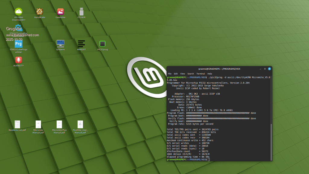

Posts: 10073
Posted: 04:37am 30 Oct 2025
Worked a treat:
Easy-peasey.
