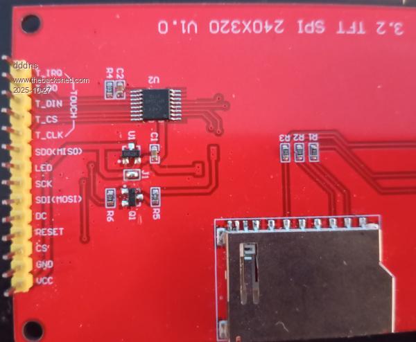

Hello,
I remember there was a discussion how this issue could be solved
by modifying the circuit. Something with removing a diode and adding a bridge/resistor.
But I cannot remember what exactly there is to do.
Would somebody who knows please help me or point me to the discussion?
Many thanks!

Hi dddns,
Look at U2, there is something between pin 7 and 8. A short ?

  Volhout said  Hi dddns,
Thank you for answers.
@Volhout
After I posted the picture I saw it for the first time. Even with two reading glasses as sandwich this was not visible to me.
I will give an update

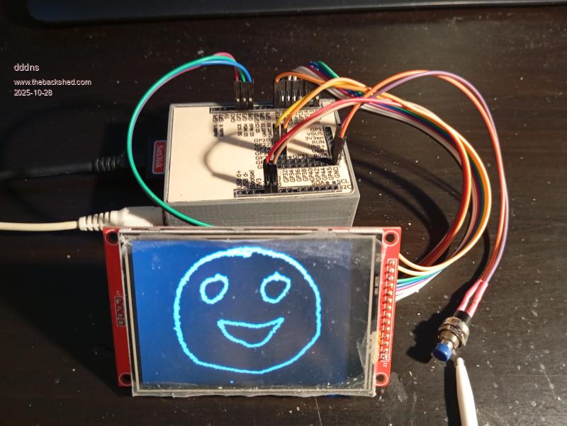

I got it :)
it was a bumpy ride but finally everything is working.
First there was this short and another electrical issue.
And then a longer journey to find a pin assignment which works with all devices.
Touch was not possible to get to run clean as use this config, e.g Option touch gp20,gp21 wold not work. Having system spi on gp22,gp23,gp20 doesn't work either.
But no problem, this is working:
