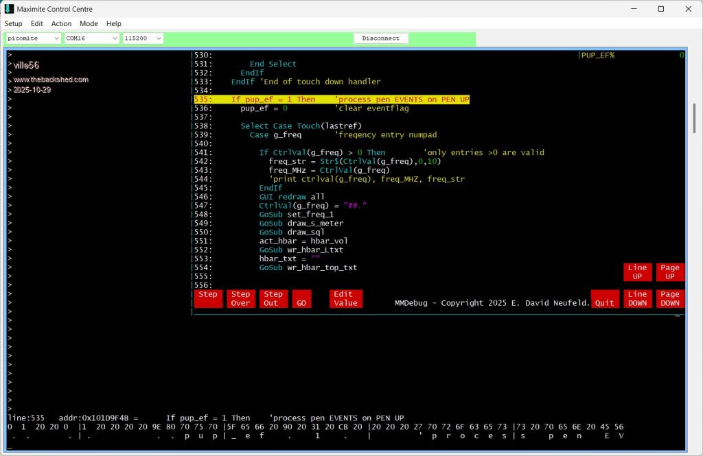

If I use the page up/dn key, I get some lines at the bottom of the screen. Is this something new?
73 de OE1HGA, Gerald

Yikes!!!   That is some debug code to show the tokenized MMBasic program and where the interpreter is 'Executing'.    The first vertical bar is the pointer to the line being 'Executed'.
You can toggle that being active by pressing the ~ key.
I don't know how you found that, but I'll get that fixed and re-released ASAP.
@ville56    The timing of USB Serial characters has changed significantly.   If (from the command prompt) you type > EDIT it will bring up the full screen editor.   And the Page-Up and Page-Down buttons are not working there either.   Somehow the Page-Up and Page-Down keys (which include ~ in their sequence are not getting interpreted correctly).
The Red Menu items at the bottom of the MMDebug screen have Page-Up and Page-Down.   Those do work correctly.    You can use those until I figure out what needs to be done.
Edited 2025-10-29 23:20 by EDNEDN

must have been a pg up/dn escape sequence then ... at least I can switch the debug lines on with it, reliably.

Yeah...   The VT100 Escape Sequences are kind of a mess.  Between maintaining compatibility with the VT52 and adding new features it is kind of a nightmare to parse efficiently.    And you can't really parse the sequence until the entire sequence is available (because all the parameters come first and then finally the actual command).
While I was in there, I shifted the Debugger to respond to the Mouse Click Up instead of Mouse Click Down.  Taking action on Mouse Click Down is more natural.   The reason for the change is when the user Quits, or Step's or Go's both Tera Term and MMCC are now sending Mouse Click Down followed by Mouse Click Up.   It is much more deterministic for the user's program to not have a random Mouse Click Up coming in.  This change (if nobody complains about it) should eliminate some of the gibberish the Mouse was generating when the Debugger is not in control.
Please let me know if this behavior change works OK for you.
