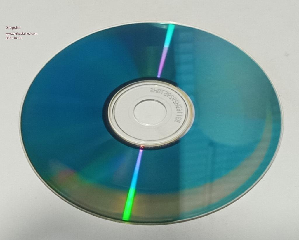

But I DID find one that was impressively degraded - we're talking 25 years since it was written, back on 20th of May in the year 2000....
Surprisingly, ALL OF THIS DISC was readable, as the writable area HAD NOT been affected....but it was millimeters from being so!
Here is an image:

Hi Grogster,
I had some nasty surprises with these transparent sleeves that you can use to store CDs in folders.
After two to three years, the plasticizer in the plastic sleeves caused thumb-sized holes to appear in the coating of the CDs.
No, the CDs were no longer readable.

Wow!
DVR-R and CD-R mediums were never designed to be long-term data storage, so I guess I'm doing OK being able to read most of the ones I have tried so far!
But that's the first I have heard about the plastic sleeve issue.
I've stored all my original CD's and DVD's in folders like that.
Perhaps I had better check they are still OK in there, cos I haven't touched those in years either!

CD-R and DVD-R use dye in the medium. Dye’s don’t last forever. I think sunlight can degrade the dye’s also.
Commercial CD and DVD are quite different - a thin layer of aluminum has pits burned into them when made. These have a much longer life.

Hi Grogs,
I rarely burn CD/DVD/BDR these days but I did have many `surprises' with disks not being readable after as little as 6 mths. There was a particular bad brand/model of RiTech or RiData that bragged about their organic dyes, well they DIED ok, most were not readable after a few months. These had a very characteristic deep purple/aubergine colour..
