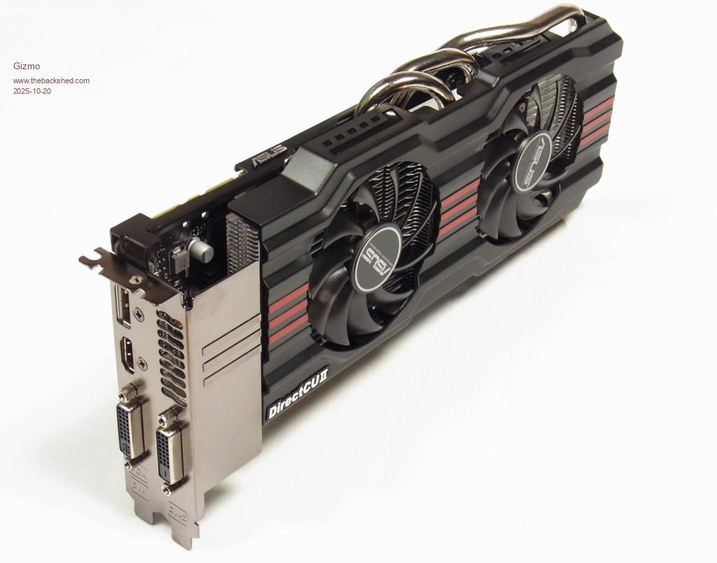

Posts: 5200
Posted: 09:00am 20 Oct 2025
This is a pic of the problem. Same model as mine, but mine has more dust. Its nearly as big as the mainboard. They are still popular, seen a few on ebay for sale.
Is heavy. I had issues once where it would sag over time, I was using a tower case. I would start to get random lockups. Switched to a desktop case, problem fixed.
No doubt using the onboard video or a new card would fix the issues, but I like games and new cards start at over $400.
I'll keep an eye on the forums, this NVidia 470 driver and dual monitors seams a common problem with Mint 22.2 and Zorin 18. Be nice to have another go if it gets sorted.
