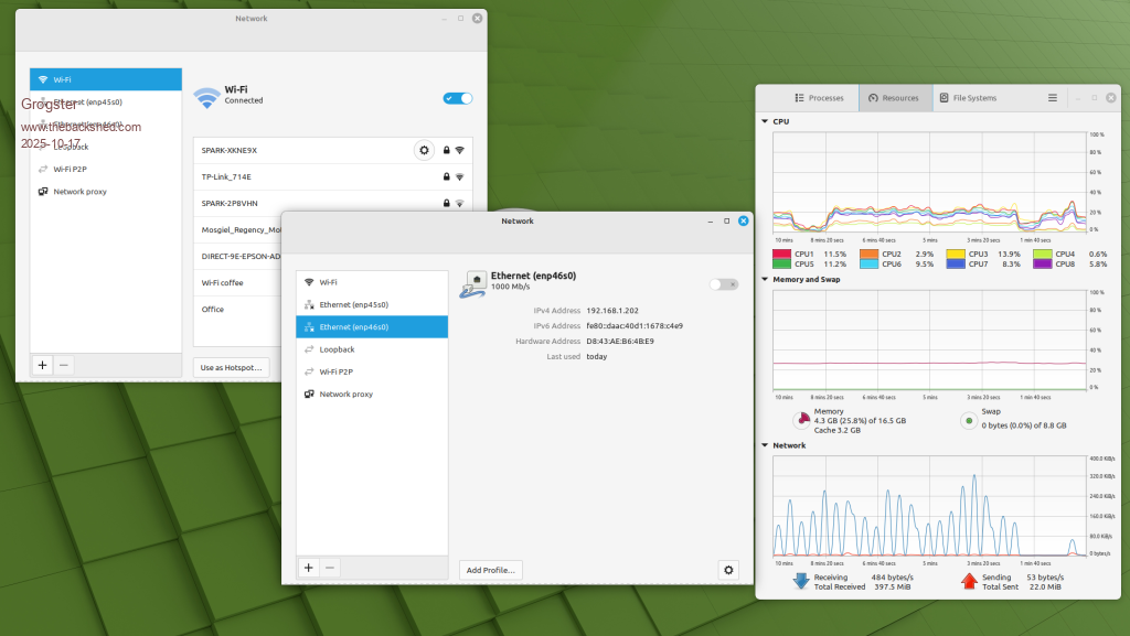

Here is a snapshot of the issue...
With Ethernet disabled, everything is fine.
ENABLE it, and BOTH the WiFi and the Ethernet stop working.
Might post about this on the Mint forums also, cos this does seem very odd...

Sounds like and could be a routing issue. Open a terminal and check with
netstat -r
ipconfig -a
your setting once you have internet access and compare it to the ones you have when both are connected and fails. Look where the default route points to and check, if router and server are really on the same network. Check the netmask and try to ping the router and your server in all situations.

Windows is so long ago for me but this ipconfig got hammered in my head. For Linux that's wrong..better try this:
ifconfig -a
The Lan network (always) gets the first place in routing table where traffic goes.
If you connect your Wifi and both connections are via DHCP configured, it will keep the Lan as default even though your Wifi offers another default route. The Lan will  be prioritized IIRC

It will come down to routing and such like. The network switching in the top level network manager is fairly simplistic a+nd usually assumes that you will have one network live at any one time, and if you activate another interface that will be the one to use. Static IP is irrelevant is all the same to the network drives if it's dhcp assigned or not.
I assume that what you have is a local network on wired ethernet one one network say 192.168.10.0 and a wifi network on 192.168.11.0. These are two separate networks on separate interfaces, and by default they will NOT talk to each other. You can add various routes to direct the traffic destined for the outside world (internet) to go via the wifi network. Another option which is often automatically set up is to form a bridge between the two networks, which allows each network to "see" the other, in that case the default route will normally be set to the interface connected to the interface that provides the external internet access.
As an asside, you can have as many networks as you want on a physical interface, so on the local ethernet you could have 192.168.10.0, 192.168.12.0, and  192.168.14.0 They will happily co-exist. This is known as multinetting, and is very frowned upon generally as it opens up all sorts of security issues, however it is very useful in the case where you need to move a entire network to another IP range, but keep everything running while you do so.
As you only have a few machines, I suspect that the simplest solution will be to add a route from the wired ethernet network to divert all non local traffic to the wifi interface. Set the default gateway on the ethernet to the wifi ip and that should do the job. That should make the ethernet divert traffic to anything other than it's local network to the wifi network. There is a routes buton in network manager on the bottom of the IPV4 tab (I'm assuming that mint is using the same GUI system as Debian...) if not it should be fairly obvious or googlable :-)
