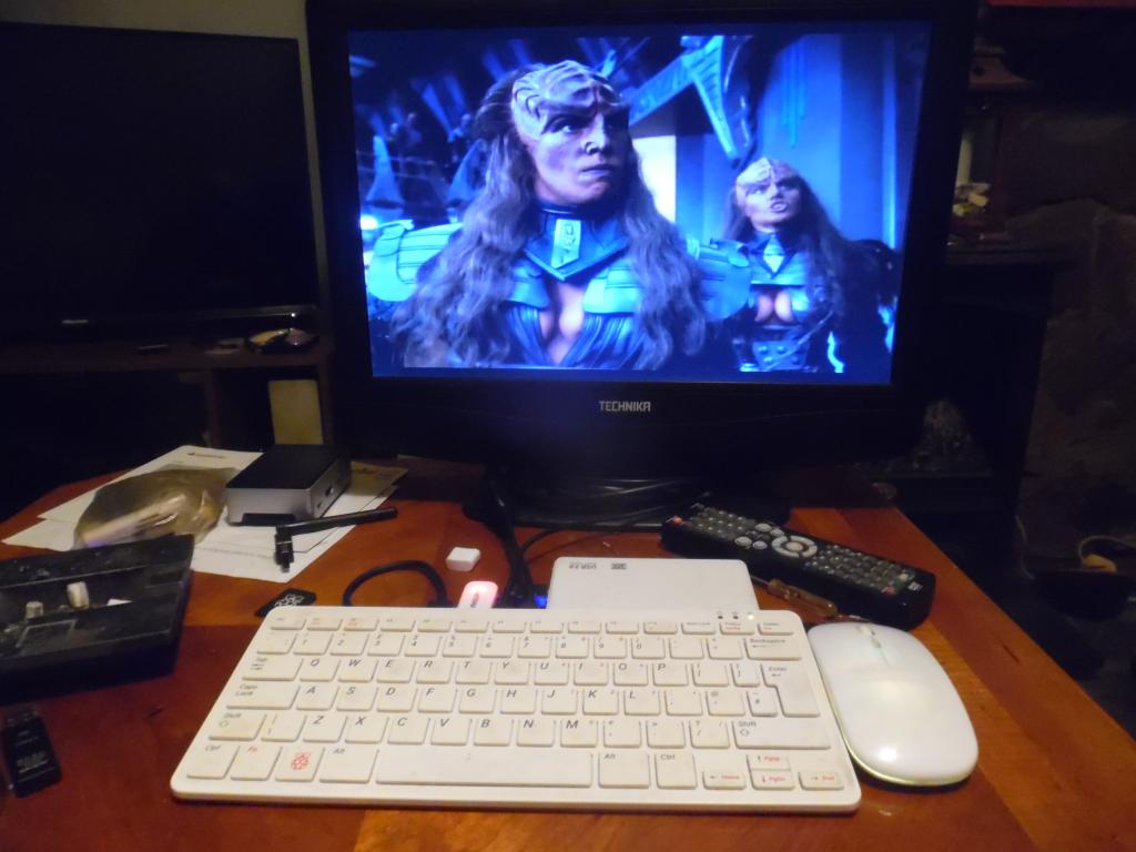

wrong place to post but for rpi 400 the new Trixie os is interesting.. a boot menu on start so sd card or usb ssd. got it set up on 128gb sd card and 120GB usb 3 ssd and same but seeing if ssd is faster experience than sd card.
I only using it cos it's linux and make a retro game console.
This is a test post.
I dunno if the graphics have been improved ie hardware but runs like win 11 ie quick and vlc plays usb mem fine and youtube is good,
sorry, just installed and happy

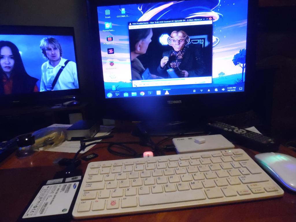

I added these lines to config, which is in boot/config.txt now and it's fine but have to check with conky or summat. got stuck with a RpiLinux app that shows everything but couldn't remove it until repowered
arm_freq=2200
over_voltage=8
# Run as fast as firmware / board allows
#arm_boost=1
@Gizmo, I was TwisterOs 32bit fan. I had a 250GB usb3 ssd full of roms fail and then the rpi400 keyboard went faulty, got many keys said 3. coincidence?
Installed last rpi os 64bit and keyboard was fine??? same with Trixie, all rpi os named after Toy Story characters??
The 64bit os versions seem "better". try
the multi boot is new. got 128gb sd card with trixie set up and 120gb usb3 ssd with trixie set up and can pick either then it seems to remember the last boot device and uses that. I seem to remember getting rpi400 to boot from usb ssd was lots of linux stuff.
sorry if wrong place to post but there are linux and rpi pico users and rpi400 runs on linux. mint isn't everyone's favourite or ubuntu imho.

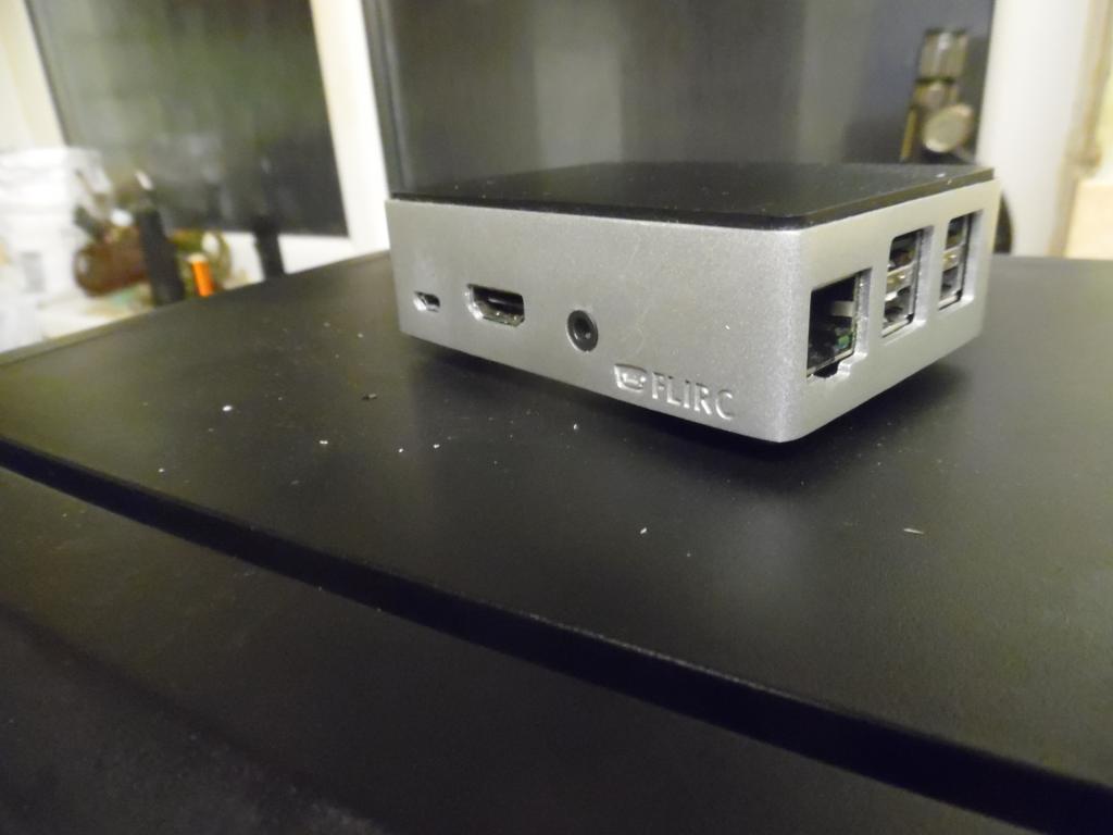

Mick. I got a raspberry pi 3 . the case is the heat sink.. but it won't run 64 bit.
Posts: 9081
Posted: 07:28am 16 Oct 2025
It should do, it's got a 64-bit CPU. I like the case. :)
