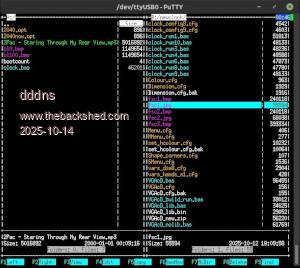

It was open in a tab in my editor and I haven't touched it for months. Now I found the time to add the for me missing peaces. I have just finished it and it isn't fully tested but looks very good.
So this is, with many thanks @ Javavi for his nice code, a minimal version of his FM172. I added and modified some lines and deleted all I don't need.
The changes:
it runs on all platforms in colour
it resizes putty and leaves a clean screen when closed
uses only characters below 128 so looks good in every constellation
all Coulour calls are replaced by a sub routine call
the subroutine sets the colour for console and/or screen
the terminal size for console only can be set with a variable at the beginning
colours for cursor and F-keys can be set with a variable at the beginning
replaced the ISR to set the time
clears the input buffer for inkey$ so cursor stops immediately
added a keypress_delay variable because it's too fast now.
Runs perfect on my ssd1963 LCD on a RP2040 (which was the major reason doing it)
This is a one time work I don't want to follow up because it runs good enough for me.

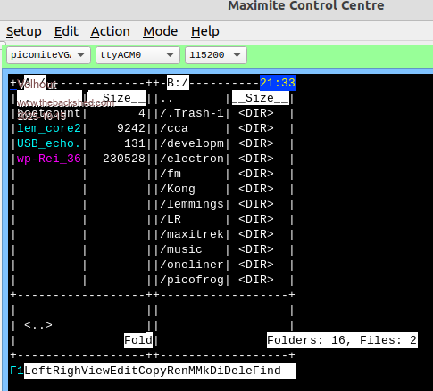

No, you did not fix the issue. The problem is that you are defining a few constants, and then change to mode 1 (MM.HRES etc.. change)
If you are in mode 2 when starting the miniFM you get this (both VGA and console(both Putty and MMCC)):
My changes fixed that.

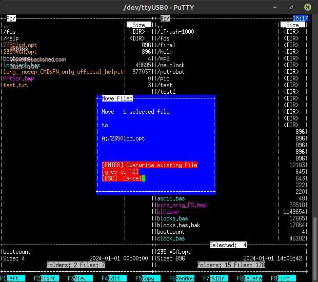

Posted: 02:27pm 19 Oct 2025
Hello!
I spent the last days to get it complete.
The changes:
- the init routine is complete
- the main loop is done
- dialogs are rewritten and done
- dialogs and everything is centered
- dialogs have an option for confirm, "yes to all" and cancel
- you can set behavior for confirm and overwrite
- Everything scales correctly from 5 x 37 to 100 x 240 characters terminal size
- on VGA and HDMI in all Mode 1 resolutions
- Took special care for LCD and it should run from ILI9341 320x240 to any.
- On LCD you can chose any system font
- code cleanup and formatting
There are still minor cosmetic issues.
Error handling is not done yet
I haven't touched the backend subroutines at all. All I can say is that they run super stable and deliver correct answers.
Please test this and comment!
minifm_RC.zip

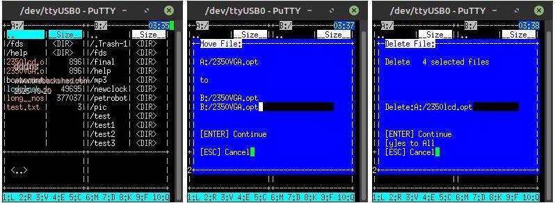

smallest possible, here 40x20 like on a ILI9341:
Standard 80x24:
'Custom variables-----------------------------------------------------
 Dim integer confirm_each = 1 '0:Don't ask, 1:always ask
 Dim integer overwrite = 0 '0: alwasy ask, 1: don't ask
 Dim integer run_bas = 0 ' disable Enter to execute .bas file
