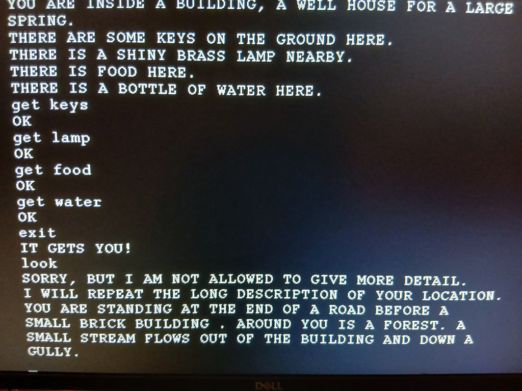

It is working. But the commands are very different from Tay's. I may have to decode (it is a ROT-13 cypher, like used for GeoCaching) to learn the verbs.
It does not know "Inventory" or the likes..

I encrypted it myself using ROT-13 to prevent accidental spoilers; in the original list, everything was in plain text
yes, i was suprised that it does not know "Inventory".

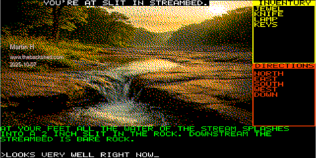

As shown in the image, the GUI version will have a field displaying what the user has with them.
The images are almost finished, and I will then try to integrate the GUI into the text version of the adventure.

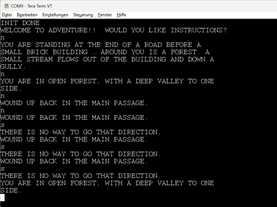

1/ start new game. press "n" 2x -> error in line 293.
  at many locations in the game pressing "n" several times causes the same.

  Quote  1/ start new game. press "n" 2x -> error in line 293.
Ive done a lot of debugging, this should be Fixed.

The pictures are beautiful.

Pictures "a69.bmp" and to a lesser level "a71.bmp" use a different colorscheme. They do not match the rest of the pictures. Maybe that is intended to be.
I like "titel.bmp" better than "titel2.bmp", but that is obviously matter of taste.
Looking out for the implementation of these graphics in the game. Really exciting !!
