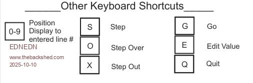

That is a good idea.    In the meantime, if you load up the 10 Minute Tutorial it will let a person see all of the important features the debugger provides as it steps through the sample program.
And the 'Cheat Sheet' does let a person see what it looks like and how to do various things within the debugger.

Hi EDNEDN,
Great work,
I'm also impressed by how it's implemented in the terminal.
Until now, I've always used “printf” debugging and also tried using ‘stop’ as a breakpoint and “continue.” But that only works in the main program. Also, only global variables can be “printed.”
So, everything's great for me! I had never dreamed that this would be possible in MMBasic.
You already evaluate keys for changing the width and height, maybe you could also add a key for “step”. With the mouse, I think you have to concentrate more on hitting the button, but with the key, you can just leave your finger over it.
What is the preferred transfer method for the programs? Up to now I used XMODEM, but I had problems with the debug version. The progress stopped after 512 Bytes
Ultimately, we probably need a full manual.  But in the 'Cheat Sheet' it says:
