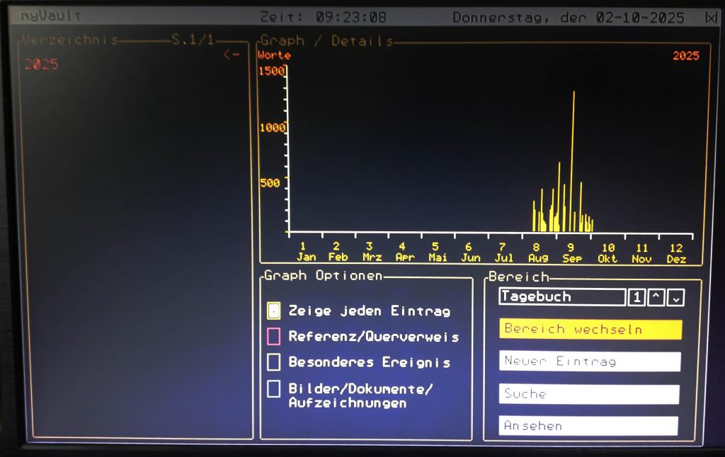

I am heavily working on the translation of my journal/diary program including GUIs for the PicoMite HDMI (USB!) version, because I started this project in pure German.
The Problem: I was using the PicoMite HDMI PS/2 version, in this version I am able to
read in the raw ASCII value via the command:
MM.INFO(PS2) '(Reports the last raw message received on the PS2 interface if enabled.)

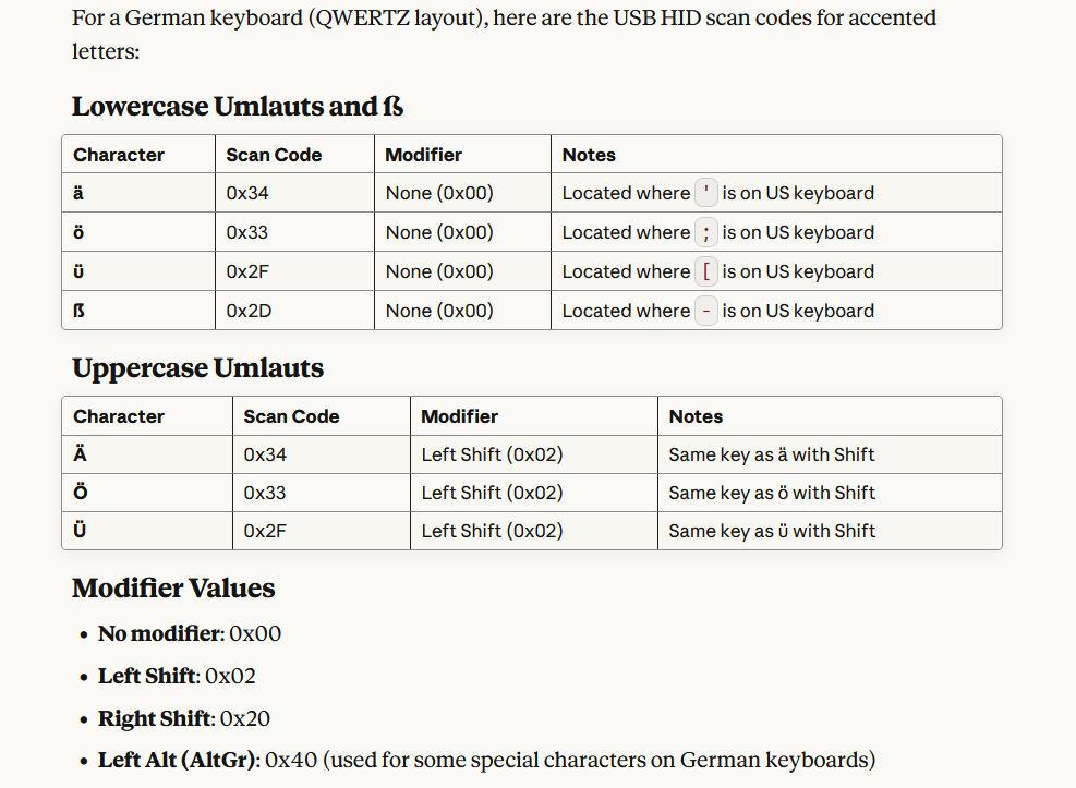

Why would I do this? Simply because this allows me to read in the raw key of German Umlaute (ÄäÜüÖöß) and map then to a custom font made by Martin, which has all the German Umlaute in it.
So for converting this already huge program, I have written, to the USB version, I desperatly need to read in the raw USB keys of those Umlaut-Keys, too. I can't find any command for this. I was optimistic that:
keyDown(n)
will do the trick, for the USB version - but it doesn't show anything when I press on my German Keyboard "ÄÜüÖöß" - so there is no solution for me, to translate my software for the German USB version (and after that to the english USB version).
I really hope there is a solution for that, if not I have to stick to the PS/2 version - which is ok, but sad, since Peter fixed the missing keys on the USB version many iterations ago
Only for the interested, a short program description:

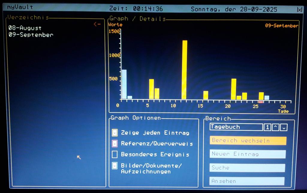

Here are some images of the already finished (german version) of my diary/journaling
software, it also includes a text editor, excessive graph options to show different parameters. And it doesn't stop there: you have in fact three different working areas:
diary/journal = German = "Tagebuch"
health        = German = "Gesundheit"
notebook      = German = "Notizbuch"
in every area (German = "Bereich") you have different visualisation parameters for the graph. For example you can track your: pulse, blood pressure, stress, words you have written on the specific entry, and you can even add own comparison parameters.
There is a search function, which allows to search a whole month for specific words.
The program is split into six different (chained) programs.
Greetings
Daniel

The solution (or at least part of it) is your new function MM.USB, only here I have the chance to "catch" any output from the mentioned keys.
So my only chance is to do the following:
1. read the raw key (ä,ö,ü,ß) via MM.USB
2. check via keyDown(7) if SHIFT-key is pressed
3. manually map the "ä,ö,ü,ß / Ä, Ü, Ö, ?" to a custom FONT, which Martin kindly created
Problem: as soon as I use "keyDown(7)" everything is "laggy", keypresses are skipped or ignored.
With PS/2 I did the same (only of course with MM.Info(PS2)) and it works just perfect! No missed keys, no latency at all. I hoped, that this workaround would also work for the USB version. This way one could implement ANY keyboard layout.

Posts: 12058
Posted: 09:51am 03 Oct 2025
If you provide a list of the USB scan codes for all relevant keys and required modifiers associated I will see if I can do anything. I just need all the required unique pairings I don't care what they mean
e.g.
code modifier
0x87  ALT
0x87  none
Posts: 12058
Posted: 10:48am 03 Oct 2025
Is this correct
Amnesie
Joined: 30/06/2020
Posts: 763
Posted: 07:57pm 03 Oct 2025
Hi Peter,
Sorry for my late respond, just came home.
Yes your list is correct. For example, If I type in your test-firmware via:
Print MM.USB (and pressing "ü")
I get: 47, which is "0x2F"
Etc...
Would be Amazing , if you could work something out for a simple solution or some function which acts like MM.info(ps2)
If you need some more testings or info, I will do my best.
Greetings
Daniel
