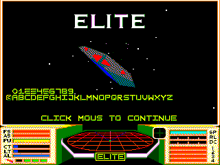

Martin H.
Joined: 04/06/2022
Posts: 1573
Posted: 11:15am 08 Dec 2025
  Bleep said  Attached is a 3D demo program, which cycles through all the Elite 'ships' (every shape is a ship) This uses the data produced by the program Peter persuaded Claude to produce, all mashed into a single program and then cycled. It's tested on a 2050HDMI, and will almost certainly work on a LCD with minor mods. Latest firmware.
Regards Kevin.
3ddemo.zip
Nice Kevin,
Here is the corresponding HUD (incl. Font) in RGB121 inspired by the Archimedes version
'no comment
