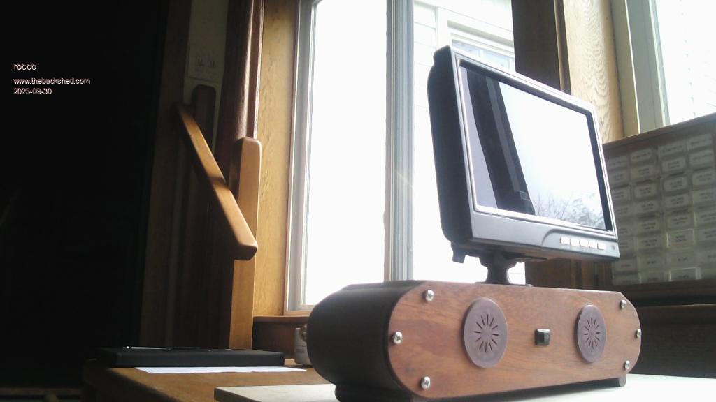

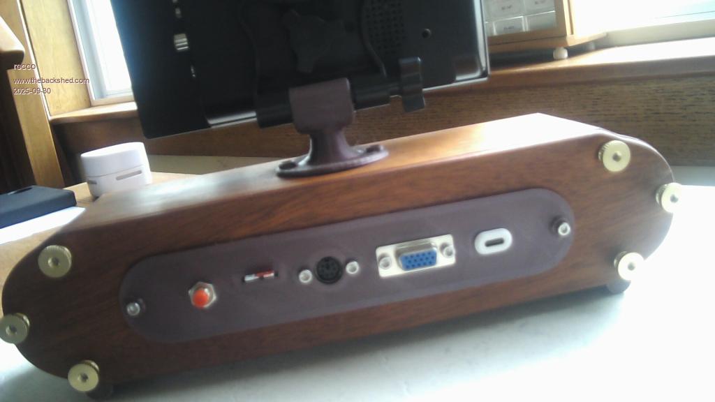

Sharing two photos of my PICOMITE (VGA, PS/2) Build. Using Christopher Barnatt's (Explaining Computers on You Tube Video) breadboard build as a starting point, then enclosing it in a custom made 3D Printed and Wood (Cherry And Mahogany) Hybrid case. I added audio using an adafruit's Max98357 I2S amp and 8 ohm speakers, Back of case allows power in with USB3, reset switch, PS/2 Keyboard connector, VGA connector and SD card. At the front there is the on/off switch and a pair of speakers. Looking forward to back to the past experience.

That looks very nice! I love the Mahogany look and the very unique shape.

I've used wood boxes to house a few projects, but nothing close to the quality of this Rocco. Nice build.

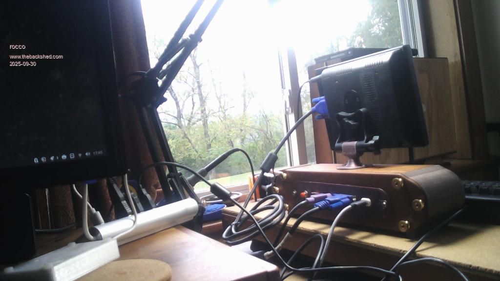

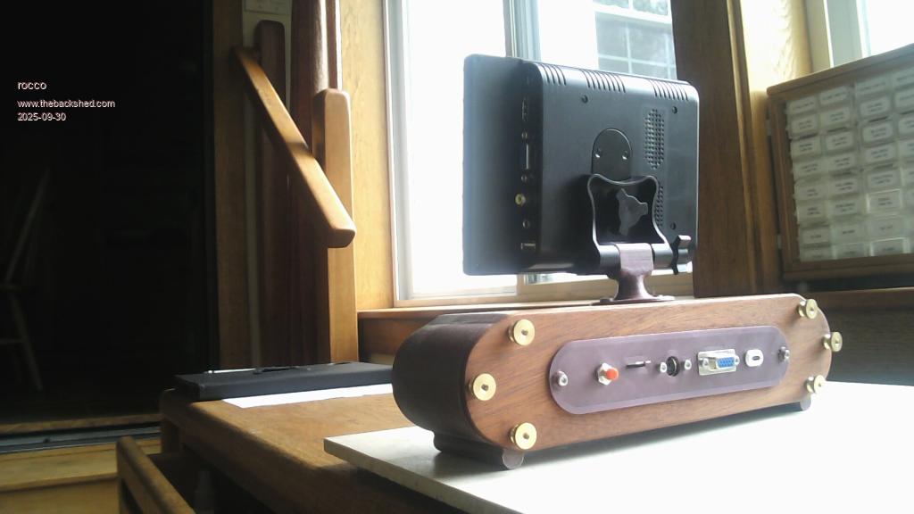

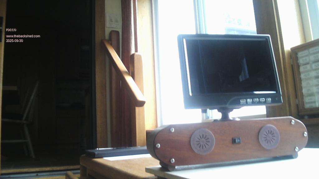

Here are some other photos of the enclosure without the clutter of wires as requested

Oh, I love it! The terminal nuts on the back are really cool  :)

I did not want shiny, but favored a slightly steam-pinkish look hence the knurled brass nuts at the back. I was tempted to add a few LEDs but decided  that would be too garish.

The screw heads on the front panel were niggling me a bit. Then I thought of this sort.
If you could find some, even if too short, you could couple onto threaded rod using a FF standoff and a locknut inside, so the back would look the same.
Just an idea. :)

I Thought about the screw heads my initial option was to use brass bolts and to fill in the head with solder, but the cost of them was excessive, I also thought of 3D printing some kind of cap in the same colour as the rest of the plastic parts. But compromises.
