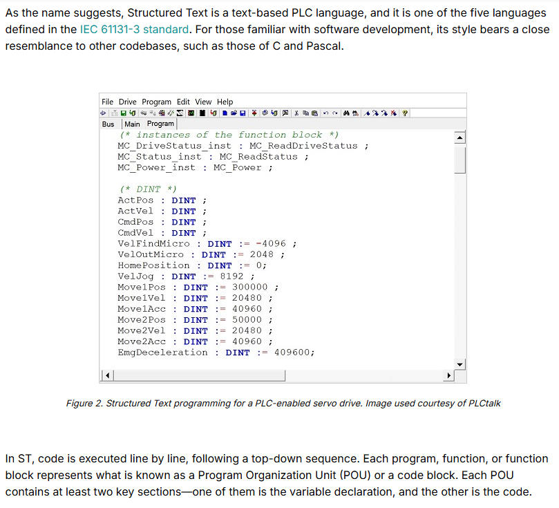

"Let's use := instead of = and a semicolon to terminate each line so that we don't have to admit that it's BASIC"

Exactly, all you doing is the work that the compiler writer should have done.
everyone knows when you have a comparison or assignment.
In all the years that I have been programming (mainly old assembler stuff) there was never any issue between the two in whatever language was used. It was defined by the operation.
Also
Move1Pos : DINT 3000000 ;
Type of syntax seems very clumsy. There is no need for the : between the variable name and the type, the space delimits the two, I don't know anything about this language but I'm a bit suspicious of the : (maybe the ; as well) It looks as if it is looking for {space}:{space} or {space};
i.e.
would this confuse it?
foobar   : DINT 3000000 ;
boojum : DINT 3000000   ;
If so it's just as bad as the Python indent madness and the programmer is being made to do the work that the compiler writer should have done.

In such as
Move1Pos : DINT := 3000000 ;
it looks like the spaces are optional and put in by a human who preferred them.
I can't see anything wrong or odd about that.

  JohnS said  In such as
Move1Pos = 3000000
Job done. Why the BS?

I expect they want to define its type so it can be checked and/or more efficient code generated.  Neither of those is BS.
Defining type helps avoid programming bugs
MMBasic with OPTION EXPLICIT does that, too, or are you saying that's BS?
