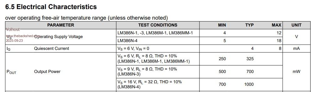

Hi,
LM386 cannot provide a lot of power when powered from 3V (3V3), this advertisement is a big lie.
- use 5V minimum
- 12 watt... NEVER, 1 watt is more likely.

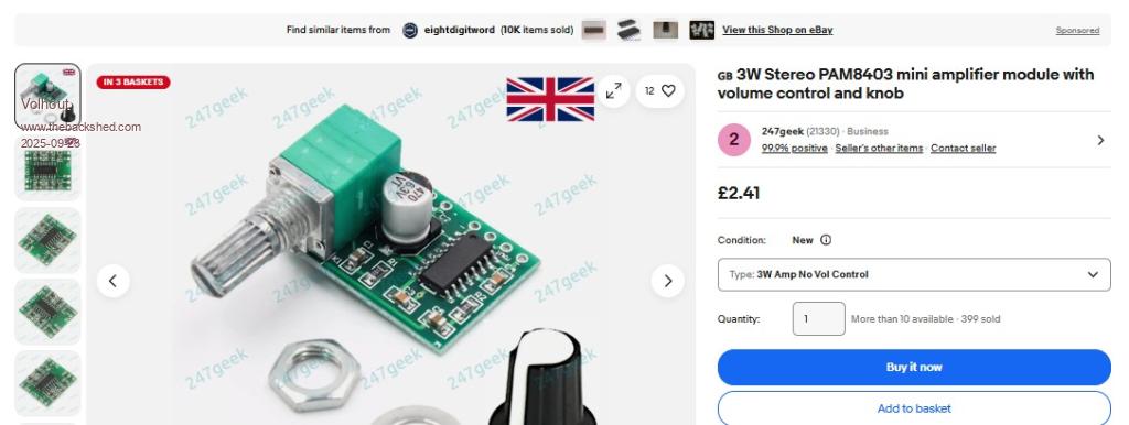

Posts: 11784
Posted: 09:26am 23 Sep 2025
In my latest design I've used the PAM8406, stereo in a single chip and almost no external components - class D/AB selectable. I'll report more when the boards arrive.

  Volhout said  Hi,
Who said I was powering mine from 3v3?
I'm using 12v for the amp module, rendering around 500mW or so of output with relatively low distortion.  I tend to ignore any of those output power figures, when they state a distortion of 10%, cos that's a hellishly high distortion figure!
As per the claims in the listing - yeah, they often lie, but I am trained to ignore anything they say in the tech specs side of most of those listings now.  Locate the main device - LM386 in this case - then use the authentic device datasheet, so as you say around 1W maximum at about 16v with 10% THD, so certainly not Hi-Fi as I mentioned, but perfect for sound effects etc.
But using 12v for power.
I'm aware of those other amp modules also, but in this particular case, I needed a module that was:
# Small
# Had on-board 3.5mm stereo socket for the input
# Had some kind of on-board volume control
# Had terminal blocks for the speaker and DC in
These modules satisfied all those requirements, other modules that just use pin-headers or PCB holes for the various input/output/supply, were not suitable in my situation.
Having found the module, I was suitably impressed with it, so linked it here.
EDIT: The module that matherp linked to, would also be perfect for my needs.  Wasn't aware of that one before I followed the link.  I only needed mono, but you could just use one channel and not connect anything to the other channel I guess.....
