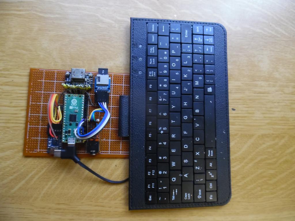

Posted: 04:01pm 17 Sep 2025
I only use mmedit so need usb to ttl converter that has 5V and 3.3V supplies out. 5V to pin 40, drives usb kb and pico, 3.3V drives 3.3V sd card reader.
ps. only dual pm header socket soldered, rest temp wired to try. All fine
Edited 2025-09-18 03:25 by stanleyella
