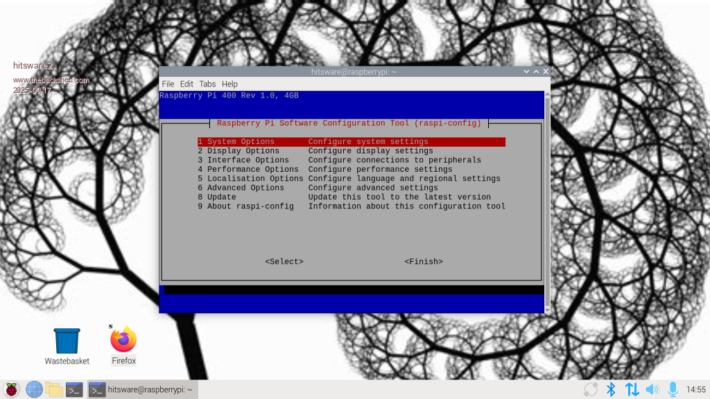

Posted: 02:06pm 16 Sep 2025
  stanleyella said
not easy now to edit config.txt.
sudo raspi-config
my site

Posted: 09:37pm 16 Sep 2025
  hitsware2 said
sudo raspi-config
sudo nano config.txt is now config.sys. not like bullseye

Posts: 9081
Posted: 06:33am 17 Sep 2025
I always used sudo raspi-config from when I first discovered it. It's definitely the easiest way to set things up. :)  I'm a nano fan too, but only when it's needed. :)
Posted: 02:16pm 17 Sep 2025
Thanks. It's been in a box for years. I forgot how it's setup.
editing config-txt which it says is in config.sys do not alter. Read the sd card or hdd in windows pc and edit it in notepad and save.Hdmi was not correct on first tv with no sound but another tv worked with the same settings.
