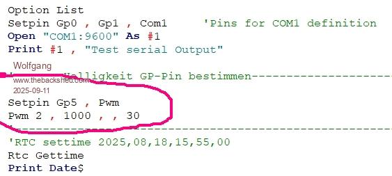

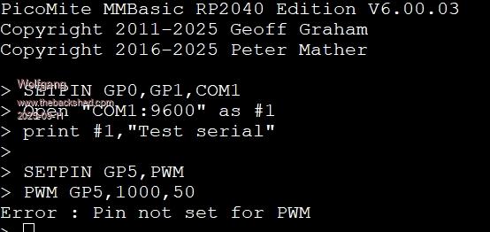

I'm a litte bit confused, because I can't manage to generate a PWM, see listing. What am I doing wrong?
The serial output is working, but PWM inputs produce an error
I tried other GP-Pins too, but no success.
Greets
Wolfgang

See Manual page 11 then Manual page 149
  Quote  To use just channel B use the syntax: ‘PWM channel, frequency, , dutyB’ -
note the double comma before the required duty cycle.

Hi Wolfgang,
PWM's on the RP2040(and RP2350) come in pairs. For each PWM block there is a A output and a B output. Look at the pinout of the Pico in the user manual. The commands in MMBasic have parameters for the A and B output separate. When not using the A output, you can leave the A parameter blank.

it works now, see picture: I hope I understand this right.
As a newcomer, I searched before through many forum posts and the manual too, to find information or examples about PWM settings, but I couldn't find an example that showed a double-comma setting before the duty cycle value.
My intention behind this kind of PWM is to dimm the brightess of my ST7796 as a function of daylight resp. night.
May be the manual can show a similar example code?
Thanks once more for your fast response.
Greets
Wolgang

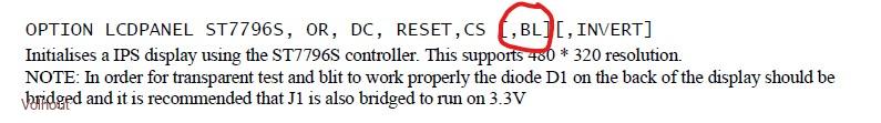

You can assign a PWM to control the backlight (i.e BL=GP5)
Using the MMBasic "BACKLIGHT n" command you can assign a brightness value.
This value can be taken form an ADC reading of a light sensor, or from a calculated time. So you do not have to control the PWM yourself. This all is supported by MMBasic commands.
Edited 2025-09-11 23:55 by Volhout

yes, the I knew the BL in Option LCD already before, but I want to control the brightness without this Options-possibility. (I am learning   , because I don't want to input the Options everytime again with a new environment)
In the meantime I have tested a little bit more, and I think, that I now understand the double-comma information.
In order to use the PWM, (e.g. GP4/GP5)
SETPIN GP4,PWM  'Channel 2 with Duty A=30%
SETPIN GP5,PWM  'Channel 2 with Duty B=50%
PWM 2,1000,30,50
Is this understanding correct?
Greets
Wolfgang

now that I understand this, I can see that your suggestion regarding [BL] in the LCD options is the more practical approach, as it appears to be the better way to control the LCD brightness.
Many thanks once more
