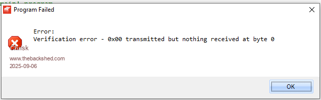

Well I thought using a PICAXE for a small function would be an easy way to go. Wrong!
I have a temporary setup to load the program but I am receiving this error.
I am using  Picaxe Editor 6 to program the Picaxe.
The program has no problem when I use the simulator but upon loading I get this error.
I don't know if it is the cable or the driver.
I have attempted to load a couple of drivers but Windows always seems to say this is the correct driver.
Any ideas?

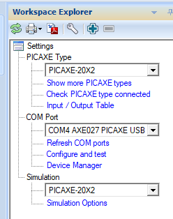

Refresh the com ports, and select from the pick list, the port with AXE027 USB Driver.
Mike

Tried doing the refresh and using Com Port 10
Windows refuses to use the PICAXE driver.

  Chrisk said  Grogster, how do I "Check PICAXE type connected"
Connect your 20X2 chip(or whatever chip), then click on the blue line below the PICAXE type drop-down box, that says: "Check PICAXE type connected"
You should get a response and confirmation from PE.

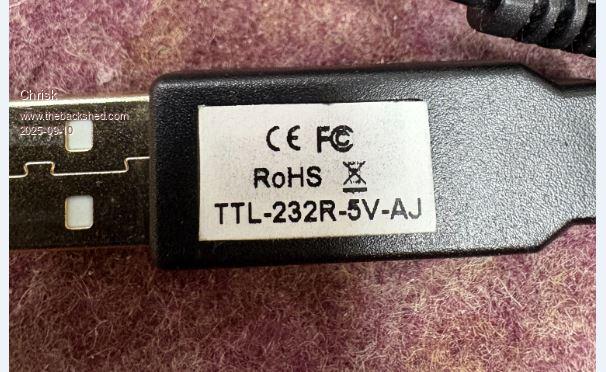

Here is the USB end of the AXE027 Chinese cable the other end is the standard 3.5mm audio connector.
The label does state 5V TTL.

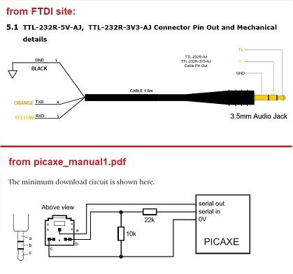

I checked the code TTL-232R-5V-AJ and it's a standard FTDI usb to TTL cable sold by a lot of companies. The FTDI datasheet shows the 3.5mm plug as
tip is Tx
ring is Rx and
sleeve is GND (0v)
But the AXE027 is wired differently:
tip is 0V
ring is Tx
sleeve is Rx
Maybe that's the issue.

The FTDI wiring is standard. PICAXE have used nonstandard wiring so you need to buy their overpriced unit.
If the signal is standard TTL serial the polarity of the data needs to be inverted, as mentioned by Volhout.
TTL serial is idle high, data low but the PICAXE requires idle low, data high.
To check this plug it into a USB port and measure between sleeve (0V in FTDI diagram) and the tip (Tx in FTDI diagram). If you get near 0V you just need to rewire the plug by chopping the lead and reconnecting the wires.
If you get 5V you will also need a pair of logic inverters.
NAND or NOR gates will also work if the inputs are connected together.
A pair of transistors will also do the job.

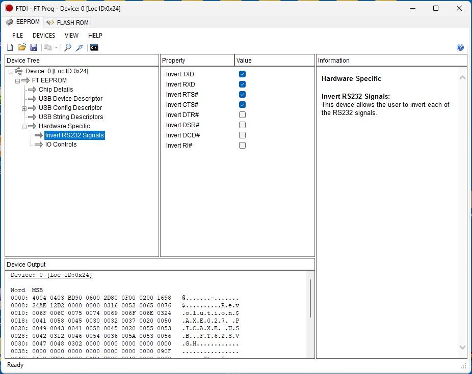

If it's using a proper FT232R IC inside the USB plug then there is a way to invert the Tx,Rx logic.
FTDI have a utility called FT_PROG which allows anyone to reprogram the IC's internal EEPROM. One of the parameters sets the logic of the signals. I've used the FT232R a lot but the only time I needed to invert the signal logic is when using it with a PICAXE. I haven't looked deeply into it but I don't think the CP21xx or Prolific USB-to-TTL ICs have this option. This is why Revolution Education use the FTDI IC.
Here's a screenshot of the setting using a genuine AXE027 & FT_PROG
Forgot to mention, if you do change any settings in the FT232R make sure you unplug and then plug the USB cable back in so it loads the new settings.
Edited 2025-09-10 11:46 by ElectroPI

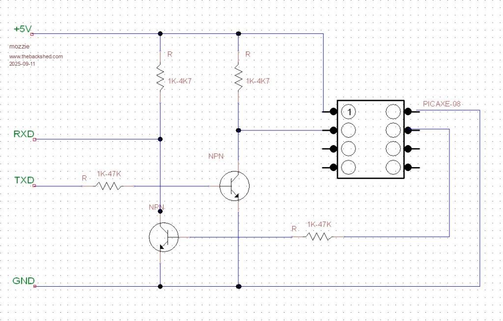

If that doesn't work I have just tested a pair of transistors as inverters on a PIC32MX170 set to use inverted serial logic and it works fine at 115200 baud.
  Quote  OPTION CONSOLE INVERT
INVERT will invert the data polarity on both the console transmit and receive lines.
This allows the console to be used with RS232 signals without a converter (see the chapter "Low Cost RS-232 Interface" in Appendix A).
It also allows the use of a PICAXE style programming cable.
> option list
OPTION BAUDRATE 115200
OPTION DISPLAY 55, 133
OPTION LCDPANEL ILI9341, LANDSCAPE, 2, 23, 6
OPTION TOUCH 7, 15
GUI CALIBRATE 0, 3956, 3841, -876, -647
BC548 transistors, emitters to ⏚ (any general purpose NPN will do)
FTDI Tx -> 10k -> Q1 base. Q1 collector -> MX170 Rx and 1KΩ to Vcc
MX170 Tx -> 10k -> Q2 base. Q2 collector -> FTDI Rx and 1KΩ to Vcc
The base resistors can be up to 100kΩ and the collector resistors up to 4.7kΩ.
If you use MOSFETs (eg 2N7000) you won't need the base resistors.
