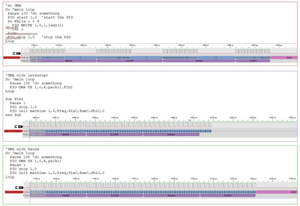

For testing the PIO-program I use the "PIO WRITE" command, DMA with interupt and with
Pause. Thats the results:
1. PIO WRITE always kills the last bit. If CPUSPEED is only 150MHz it generates a "Break"
2. PIO with TX-DMA works very good but if I use the Ready-Interupt it stops the PIO, even if there is some data left in the OSR and even if there is no PIO STOP in the sub.
3. The version with "pause 1" works spable, but then I am blocking again. That is not what I expected when I use DMA.
I think I am not the only one who use PIO. Where did I thing wrong?

PIO DMA TX waits before firing the interrupt until the fifo is clear. It can't know the status of the OSR or any other PIO internals so there is no way it can wait until the PIO finishes before stopping the processing. Your workaround is probably as good as it gets. When the PIO is running a faster process then the inherent delay in the MMbasic interrupt firing masks the issue.

I already thought to myself that the FIFO clear is the trigger, but why did the PIO stops by calling the Interupt. In the examples from the manual there is an additional "PIO STOP"? A "pause 1" before it has no effect.
