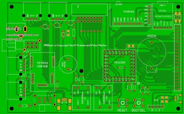

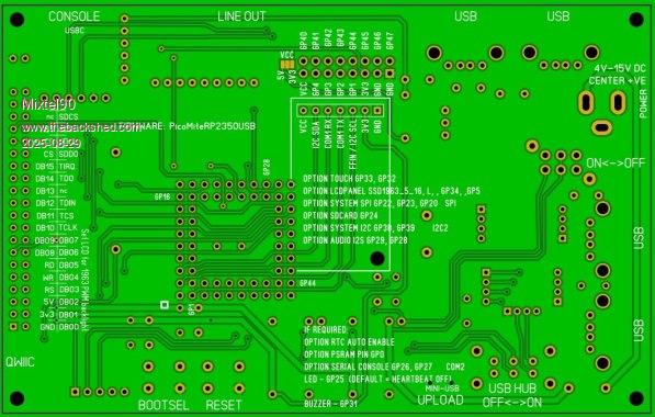

This is a design that I started ages ago but never got anywhere with it. The tracks just wouldn't work out. A few days ago I realized that the answer is to put all the components between the PCB and the display and mount the display on 15mm spacers. The back of the PCB has nothing mounted on it unless you add an optional expansion connector. 16-bit parallel display, of course. I had enough GPIO pins to play with. :)
It's still at the design stage so nothing is fixed yet.
EDIT:
Incidentally, just in case anyone is wondering at my choice of mini USB and the PGA2350B, it's because I already have them. :)  Additionally, soldering a USBC socket to a PCB is something of a challenge and only for masochists!
 The on-board LED can be either a 3mm LED connected as a Heartbeat indicator or a WS chip lifted off a piece of strip, in which case it's useless for Heartbeat but you can have pretty colours. :)
Edited 2025-08-29 03:59 by Mixtel90

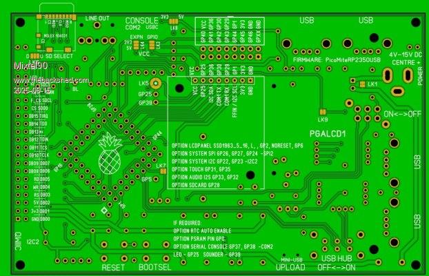

It's still progressing:
Optional separate series resistors on GP40-GP47
GP25 now available on rear expansion connector - it can be disconnected from the LED stuff with a solder blob link
Choice of different piezo sounders
Optional "true" power switch link, might be useful for battery applications
Optional LM4040 VREF added (but it had to be SMD to fit it in!)
Added a "Standby" LED off the back contact of the power switch
Quite a few track changes, some just because it was prettier. :)
I'm sorting out the circuit diagram at the moment. A couple of mistakes fixed.  :)

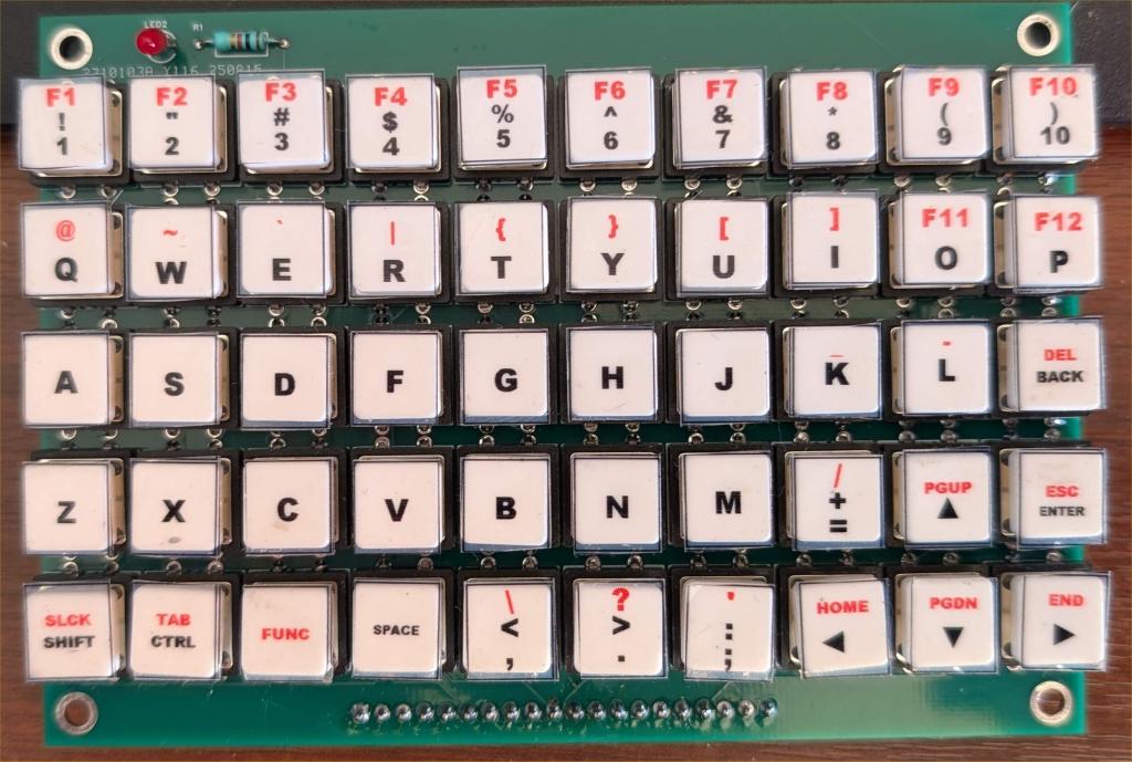

TBH I'd prefer a wireless USB keyboard personally, but others may feel differently. Nice little keyboard though!
Or, how about converting your keyboard to some sort of serial, using a RP2040-Zero?

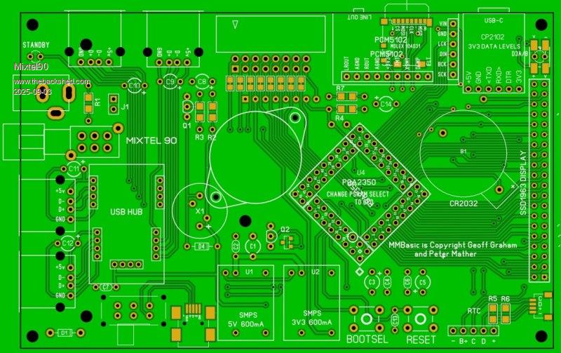

Posts: 9081
Posted: 04:55pm 01 Sep 2025
A rather big set of changes today:
Rotating the PGA2350 through 45 degrees to reduce most trace lengths on the board and neaten it. I rather wish I'd thought of that earlier. :)
The LM4040 can now be either SOT-23 or TO92.
There is now space and fixing holes for a 23mm piezo sounder.
A diode across the piezo pads allows an external 5V/6V relay to be added if anyone wanted to. Well, the space was available. :)

The idea with Peter's keyboard is great and on top yours to have a 2040 being the keyboard driver which converts to PS/2 is even nicer and you have another project..to develop the firmware :) maybe a XL version in future?

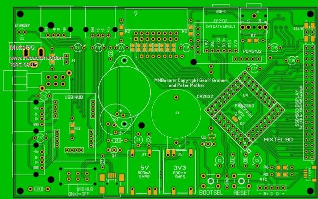

Posted: 12:01pm 15 Sep 2025
Much work later...
I think this is almost it now.
* A lot of trace optimization has gone on (you won't believe how much!)
* I'm not using the audio socket on the I2S module now. That means that pulling on the lead isn't going to endanger the module connections even though it is still plugged in.
* The expansion socket and the GPIO connector can have their VCC pin set to 3V3 or 5V independently (that's in addition to a 3V3 pin).
* The GP25 output is now more versatile.
* More decoupling caps have sprung up, together with wider traces on some major current paths.
* The power supply system has changed a lot, sharing the 3V3 load over two circuits (the backlight can draw a lot of current).
and more...
I now have a circuit diagram for it too, and most of the manual.
This morning I was contemplating adding a small relay that could be used instead of a sounder, but I'm not sure. No matter what I use it will be the wrong one for somebody so perhaps that's better remote if someone wants it. I also considered a ESP32 D1 Mini but it's a bit too cramped. One would fit on an expansion board though if anyone needed it. COM1 is available on there.

Posts: 9081
Posted: 02:49pm 15 Sep 2025
This is designed around the 5" display, which draws a maximum of about 520mA from the 3V3 rail and doesn't use the 5V rail at all.
I don't know the requirements of any other displays in the series so I've not attempted to set the board up for them. In particular, any larger displays will have no support so you would need to sort something out mechanically as well as electrically. :) The trace widths to the 3V3 and 5V pins of the display connector are only officially rated to 800mA. Any more than that and you will need to solder wires on. I can't make them much wider and can't double up on the other side as there are crossing traces there.
I have no info on 3A converters so I can't help there. I just happen to have some S09 modules. :)  If there's space I can look at it. I've found some but they have no EN input so you'd be asking that low current switch to switch the full DC load. Not great. Oh, and they won't fit the current layout either. :)
