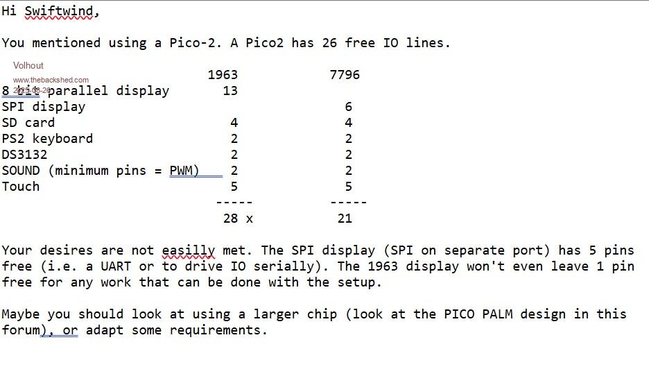

Hi Swiftwind,
P.S. On both designs, OPTION SYSTEM SPI could combine TOUCH and SD card, and thus save 3 pins. But I have no means to test if this works.

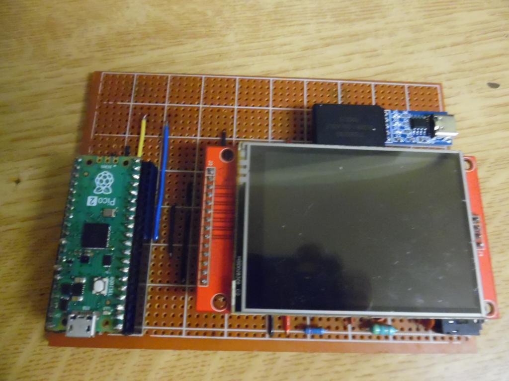

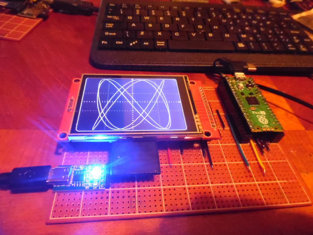

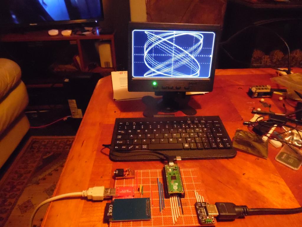

Posted: 07:46pm 26 Aug 2025
I haven't tried  SPI ST7796S but ili0341 works from the manual.
audio. sd card, usb to ttl uart. lcd or hdmi a doddle.
Edited 2025-08-27 05:53 by stanleyella

  Volhout said  Hi
The Pin diagram I found the uses 12 for the 1963:
GP0-7 for TFT DB0-DB8 (8)
GP8 KB CLOCK
GP9 KB DATA
GP10 SPI CLK (T/SD)
GP11 SPI DIN (T/SD)
GP12 SPI DOUT (T/SD)
GP13 TFT RS OR DC
GP14 TFT WR
GP15 TFT RD
GP16 TFT RESET OR RST
GND  TFT CS
GP18 T_CS
GP19 T_IRQ
GP22 SD_CS
So, if I understand it correctly, for the RTC and sound I can use:
GP20 I2C SDA
GP21 I2C SLC
GP26 PCM-A LEFT
GP27 PCM-B RIGHT
So, with the shared system SPI, it would take 24 pins total for 8 bit version.
With the ST7796S version, again if I understand it correctly, there are two 2 SPI buses natively in hardware, so without redefining pins, I assume one solution is to put the screen and touch on one bus (GP2-4), and the SD on the other (GP10-13). Then the I2C on GP6-7, keyboard on GP8-9, sound on GP26-27, and the other lines on what's left.
Edited 2025-08-27 15:06 by Swiftwind
Footnote added 2025-08-27 17:01 by Swiftwind
PCM should be PWM

Posts: 6197
Posted: 07:13am 27 Aug 2025
Hi Swiftwind,
Understood. So you have GP17 and GP28 free.
GP17 can be programmed as COM1:RX and GP28 can be programmed as COM1:TX.
So for expansion, you have a UART port free. That could allow for connecting a ESP8266 WIFI, or a GPS receiver, MAX3232 (genuine RS232 port) or MODBUS/RS485 expansion.
One thing you could do is:
GP26 I2C SDA
GP27 I2C SCL
GP20 PCM-A LEFT
GP21 PCM-B RIGHT
This would still leave GP17 and GP28 free, audio would use PWM2 channel, but I2C would map to I2C2 that you would connect to internal I2C devices like the RTC. Advantage of this new mapping is that GP17 and GP28 can be used as COM1, but also as I2C, since it is independent of I2C2.
So you could expand with Sparkfun Qwiic modules (all I2C based) or the like...
