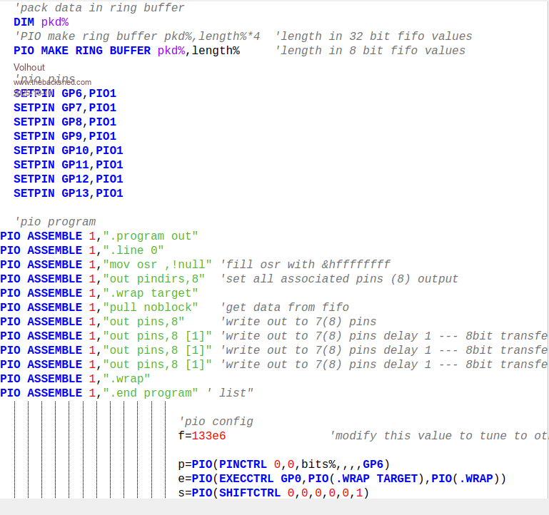

Maybe you can help me. I see a formatting problem in MMedit5.3.3 with PIO.
Maybe it is caused by the program (it has been created by the internal pico editor, and tranferred to MMedit). It may have some hidden characters in it that cause this.
This is the program
sin_gen_test.zip
The formatting looks pretty decent. But when I "autoformat" in MMedit you see this:
The PIO assemble commands are all at the left edge
And after this there are like 10 tab's left of all code.
Any idea ? This is MMedit5.3.3 (the issue is the same on 5.3.1) on Ubuntu Linux 20.04 still.
Thank you in advance

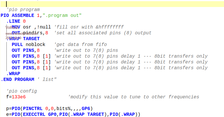

EDIT: I think it is caused by MMedit itself. The number of indent tabs for the rest of the program after PIO ASSEMBLE is identical to the number of lines that start with PIO ASSEMBLE. Something accumulating .... When I use the new structured format for PIO assemble all is sound.

  Volhout said  Hi Jim,
Hi, You have worked it out. I configured the indents to suit the new style.
I will have a look at your sample program and stop the indents accumulating.
Provide that some new medication I am about to try works as hoped, I will have an update in a few days.
