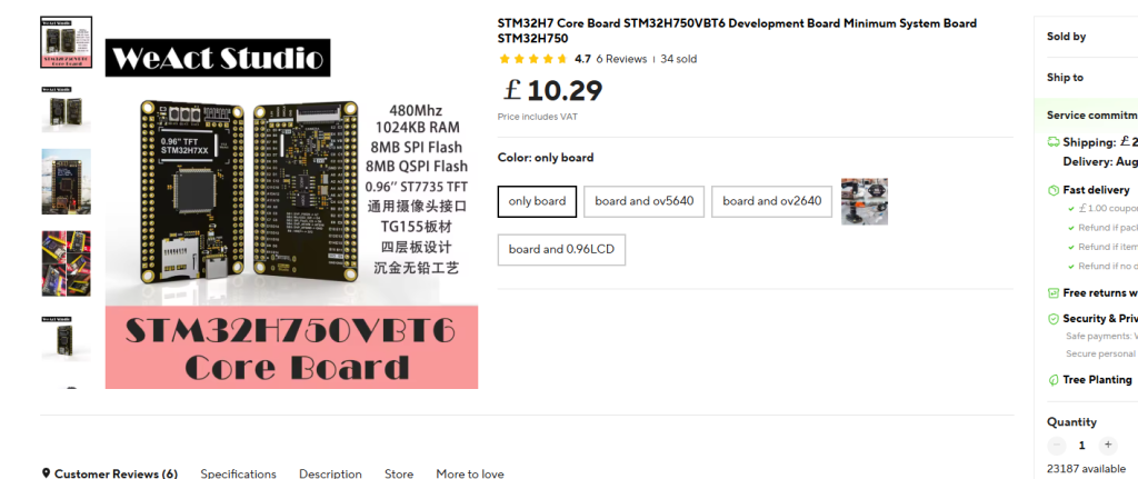

I was also wondering about:
Posts: 4372
Posted: 10:40am 15 Aug 2025
Wow! A lot of changes!
Posts: 11784
Posted: 11:00am 15 Aug 2025
Can't work - H750 only has minimal flash
Edited 2025-08-15 21:00 by matherp
