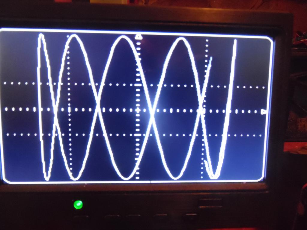

Posted: 06:34pm 09 Aug 2025
Hi. please help, using
PicoMite MMBasic RP2350A Edition V6.00.02
ili9341 lcd and tried "lissajours" prog that works vga and hdmi but not lcd, just draws graticule.
I tried FRAMEBUFFER merge F,L,N no luck

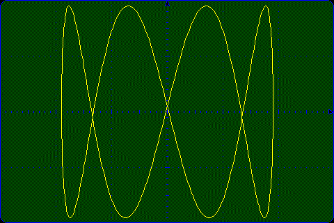

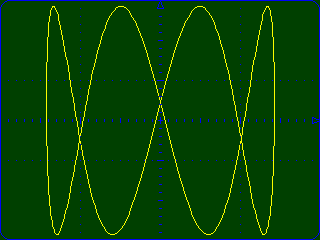

Posted: 03:33am 11 Aug 2025
Replaced the ILI9488 with a ILI9341, allowing smaller framebuffers so 2 will fit in memory.
Messed about with layers etc till it worked with the graticule. Could not get the [,B] parameter to work properly with most of the Lissajous missing. Maybe that is only for the RP2350?
Anyway this works smoothly without ,B on a RP2040 so may be even better on a RP2350.

Another working version with comments
Option ANGLE DEGREES
FRAMEBUFFER CREATE
FRAMEBUFFER LAYER
RX=MM.HRES:RY=MM.VRES:CX=RX\2:CY=RY\2
Scale=0.95: AX=CY*Scale: AY=CY*Scale
a=1: b=0: p=0: f=0: c=0
FRAMEBUFFER write L '<===== Write the following to Layer L
CLS '<========= Black is the default transparent colour
Colour RGB(Blue),0 '<========== choose graticule colour

Posted: 01:47pm 12 Aug 2025
With no changes, on an RP2350A with ILI9488 LCD.

Posted: 05:33pm 12 Aug 2025
original listing looks like this mode 5 hdmi
