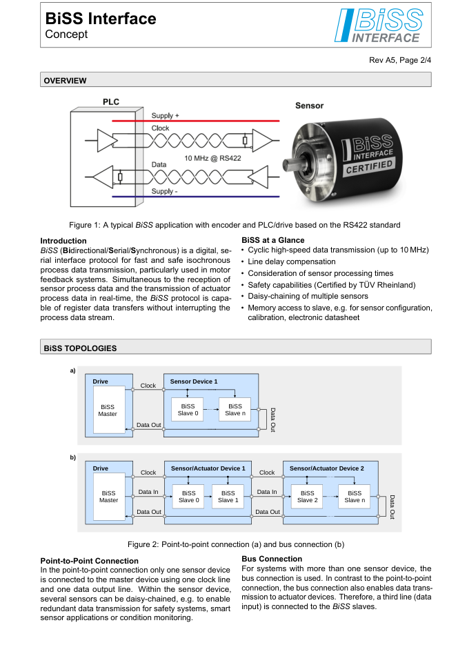

Probably a bit extreme but BiSS C is very similar to SPI (clock/data) but with differential transceivers.
I'll need to tackle this at some point.
