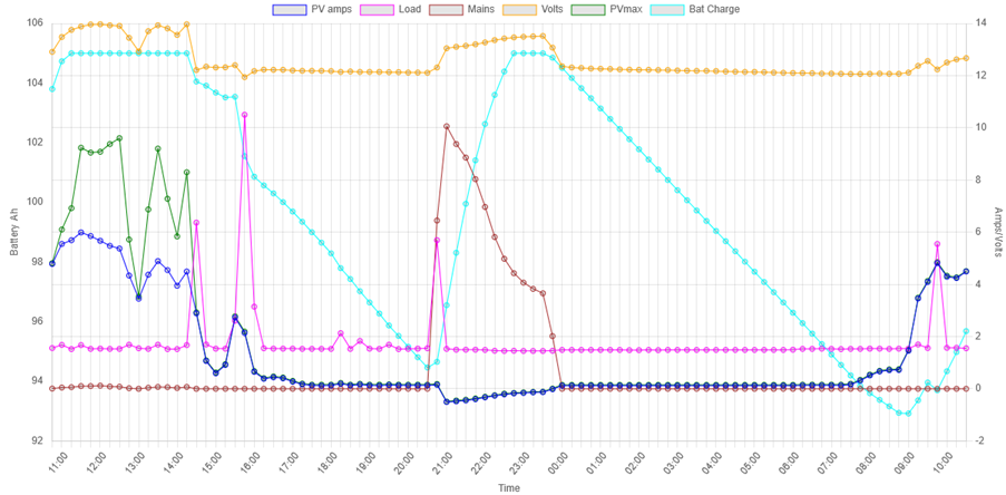

Neat graph, Jim. What are the characteristics of your battery? What makes up the near-continuous 1.8A (or so) base load (purple-ish dots) which cause the level discharge between 4:15pm and 8:30pm and again between midnight and 9am?
What solar panels are you using?
I bought several of the INA3221 modules, but have actually been using the INA226.
Can you post your code for the INA3221? Also for the graphing--very nice.
(Always happy to be trying to stand on the shoulders of giants.)

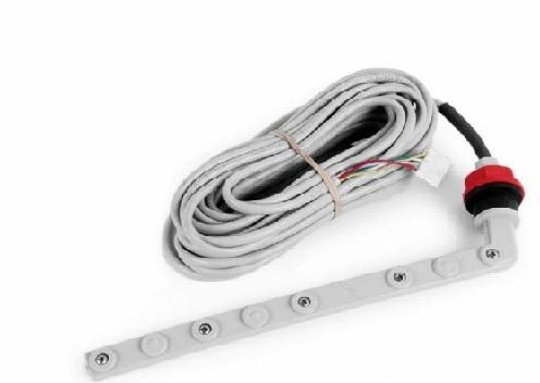

This is what I believe the water tank senders look like. I have not removed one from the tank yet but the connector end looks the same.
Does anyone know how these work?
OA47
Posts: 3361
Posted: 12:30am 30 Jul 2025
Most likely a resistor divider chain between V+ and ⏚ with the top tap connected to the output. The bottom screwhead connected to ⏚ and the other screwheads to taps on the divider chain. The water bridges the submerged taps to ⏚.
Should be easy to check with a multimeter.

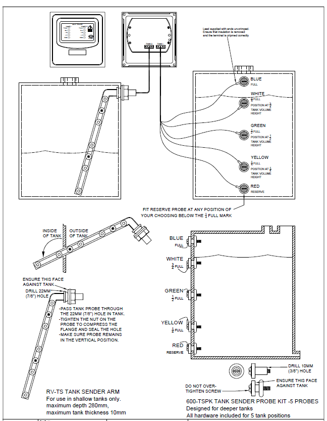

If the sensor is as pictured, it is 5 wires and will need 4 inputs to read.
This depicts a number of probes:
I don't know what impedance the probes will be but I expect high and might need conditioning before the 'mite can read reliably.
My guess is simple exposed stainless probes relying on water continuity.
I remember my caravan sensors were unreliable at best.

  lizby said  Neat graph, Jim. What are the characteristics of your battery?
Battery is 2 x 105Ah AGM
200W 12V panel.
Most of the load is a radio repeater base station. Also 2 RPi for radio internet linking and weather station.
Add a couple of 'mites hanging of the RPi and a network AP to talk to the car charger.
The charts are produced by a js library chart.js It is too big to host on a picomite (300k) so I run my data web server on a RPi5.
This contains the INA functions:
RTV_bat_mon_F4.zip
