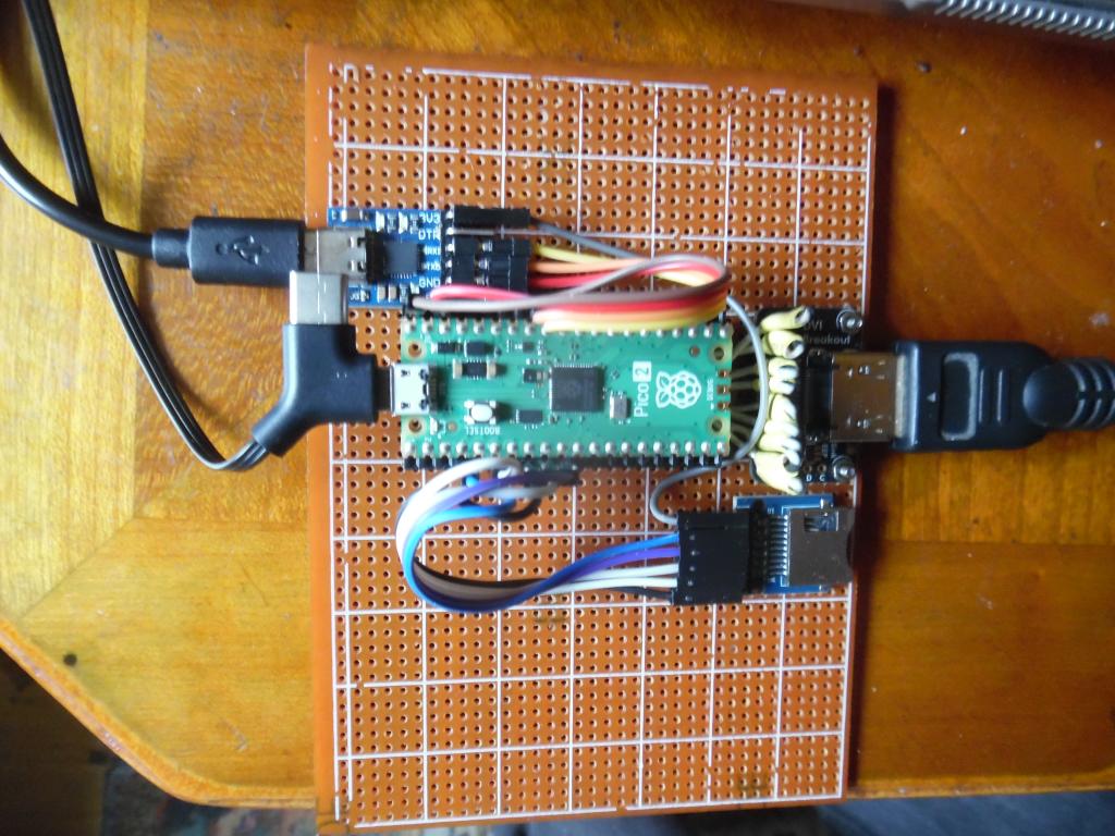

Posted: 02:42pm 24 Jul 2025

Posts: 9081
Posted: 03:22pm 24 Jul 2025
Don't over-complicate it, Stan. :)
A USB setup wants the console serial port on GP8 and GP9 *by default*, although you can change it. Keep things as simple as possible when fault-finding, with everything as defaults where possible. GP20 and GP21 will *not* work for a console unless you set them up as an OPTION. By default they are just ordinary GPIO pins.
Posted: 04:39pm 24 Jul 2025
sorry Mick, just showing usb to ttl one side of pico and sd card other. sd card needs 3.3V supply I wired from usb to ttl.
I reset the com pins and sd card pins from manual.
Roy should use non usb first try maybe and mmedit and mmcc via win pc
and default pins in the manual
Edited 2025-07-25 02:59 by stanleyella
