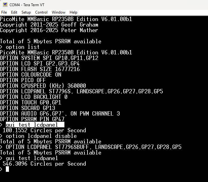

How much faster are these drivers? I've included in GUI TEST LCDPANEL an output when you exit the test that reports the number of circles drawn per second.
MUCH FASTER!!!
AFAIK all normal graphics work using the new drivers and they are tested with Petscii and work properly. Using these drivers, the use of the ILI9488 and particularly the ST7796S displays work very well as console devices. For maximum performance with the ST7796S display a CPU speed of 360MHz is recommended. This allows the SPI channel to the display to run at 90MHz giving a full screen refresh time of about 14mSec with no load on the main processor.
Of course the downside is that the screen is only using 256 colours instead of the full 65536. A later beta will include a MAP capability so that you can select the 256 colours to be used out of the full RGB888 palette.

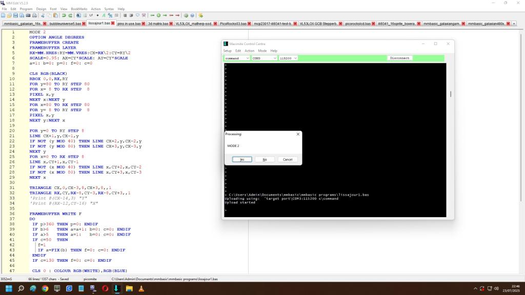

Posted: 09:52pm 23 Jul 2025
what's this new box and how to bypass it when flashing prog? please
Posts: 6626
Posted: 10:09pm 23 Jul 2025
Stan,
Your problem is nothing to do with the new MMBasic betas.
You have selected "command" as the device instead of picomite

Posted: 05:32pm 26 Jul 2025
Hi Peter,
I've reproduced your circles test pattern and tuned it to give me about 100 cps, the same as your demo, with the CPU at 360MHz and standard LCD drivers, using a ST7796S LCD panel.
I then changed to the ST7796SBUFF driver, I do get a doubling in speed, to about 200 cps, which is not bad, but not as good as your 500 cps, though I do get the same results as you using the GUI TEST LCDPANEL about 540 cps.
I've tried enabeling and disabeling the AUTOREFRESH, both within the code and at the command prompt, nothing I do makes the slightest difference, though the command is accepted, no errors?
I've tried Option autorefresh on/off, both in and out of a program, the LCD still updates exactly the same and still draws about 200 cps.
What am I doing wrong? please help. :-)
PicoMite MMBasic RP2350A Edition V6.01.00b1
OPTION SERIAL CONSOLE COM2,GP8,GP9,BOTH
OPTION LCD SPI GP26,GP27,GP28
OPTION SYSTEM I2C GP20,GP21
OPTION FLASH SIZE 4194304
OPTION COLOURCODE ON
OPTION CPUSPEED (KHz) 360000
OPTION LCDPANEL CONSOLE 7,,, 50,NOSCROLL
OPTION DISPLAY 40, 80
OPTION LCDPANEL ST7796SBUFF, LANDSCAPE,GP12,GP13,GP14,GP15
OPTION LCD BACKLIGHT 0
OPTION TOUCH GP17,GP7
OPTION SDCARD GP22
OPTION AUDIO GP10,GP11', ON PWM CHANNEL 5
OPTION RTC AUTO ENABLE
OPTION MODBUFF ENABLE  192
OPTION DEFAULT FONT 7, 1
Circle program.
Option Autorefresh Off
Dim Integer a
Dim Integer b(15)=(RGB(white),RGB(yellow),RGB(lilac),RGB(brown),RGB(fuchsia),RGB
(rust),RGB(magenta),RGB(red),RGB(cyan),RGB(green),RGB(cerulean),RGB(midgreen),RG
B(cobalt),RGB(myrtle),RGB(blue),RGB(black))
Timer =0
For a=0 To 500
Circle Rnd*480,Rnd*320,Rnd*75+8,1,,,b(a Mod 16)
Next
Print 100/(Timer/5000)
Regards, Kevin.
PS any chance of a USB version of the BUFF LCD firmware? as my test board is a USB, Thanks.
Posts: 12058
Posted: 05:46pm 26 Jul 2025
I'm using GUI TEST LCDPANEL not a Basic program. Will post a full set of firmware later.
