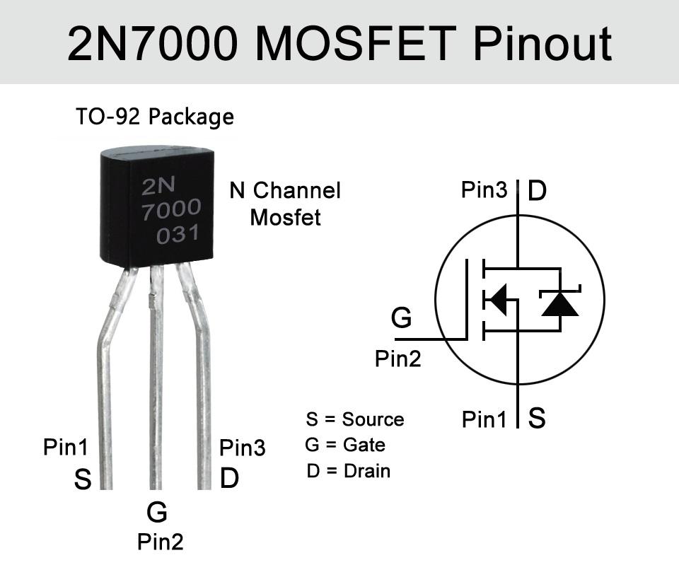

dont now how this 2N700 is connected
3v3 connected to pin 3 ?
gp8 connected to pin 1 and 2
pin 3 connected clock

How do you mean? That's a conventional level shifter circuit using a common N-channel mosfet.
GP8 - source - pin 1
3V3 - gate - pin 2
PS2 CLK - drain - pin 3
If you look at the mosfet from the top with the flat side towards you the pins are in 1-2-3 order left to right.
What you have labelled as pin 2 is wrong. On a mosfet symbol the source is indicated by both what you have labelled as pin 1 and the centre line with the arrow on it. The direction of the arrow shows weather it is N-channel )towards the gate) or P-channel (away from the gate).

3v3  connected to pin 2 - GATE
GP8 connected to pin 1 - SOURCE
CLOCK connected to pin 3 - DRAIN
