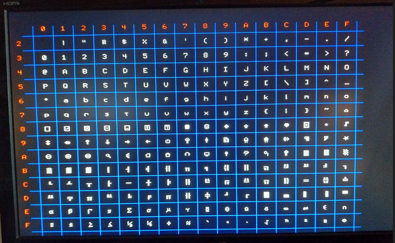

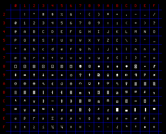

A small program that shows all the characters in FONT 1
The manual shows a table but unfortunately does not show which hex code the character has, this program shows this.
There are many characters I did not think of but that are there, such as "light bulb" = hex 97 or "SD-card" = hex 99
Is it a house on hex A5 or are it headphones on hex A7
asc.zip
It would be interesting to know who created these fonts, does anyone know?
Maybe Geoff or Peter knows the history...

  Peter63 said  It would be interesting to know who created these fonts, does anyone know?
I was also interested in this question at one time!
The lower part of the encoding from B0 to FF is clearly from the encoding of CP437 (IBM437), but where did the first one come from?
Posts: 6626
Posted: 06:41am 15 Jul 2025
The font was created for the CMM2
The line drawing characters are standard and many of the characters that would normally be chr$(0) to chr$(31) were shifted to the extended range.
Others were added as a "Nice to have"
Some of the characters are standard Unicode (or very similar) and a few were created.
There is no equivalent font anywhere that I know of.
The font was a joint exercise, much from Rob Severson who was active at that time.
Where the ASCII characters came from originally I don't know. The back tick character has been changed to the degree symbol in all MMBasic fonts.

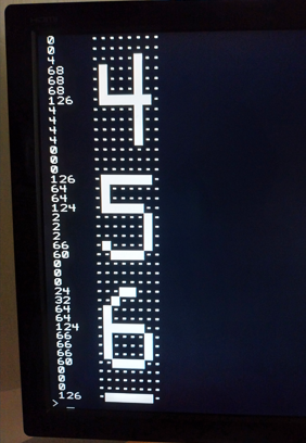

You can also print the entire FONT1 as it appears in memory. See attached program. I use MM.INFO(FONT ADDRESS 1) to find the start of FONT1.

This is what the program font1.bas looks like, where you can see the DEC code on the left. Each character in FONT1 is 8 x 12 (width x height).
