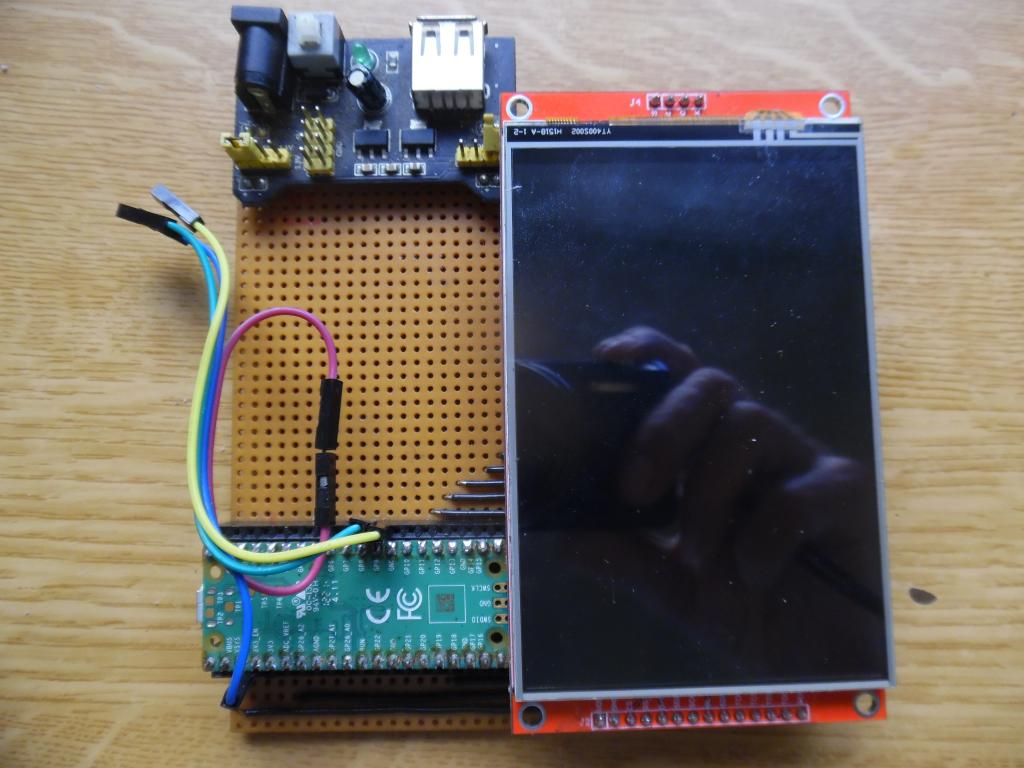

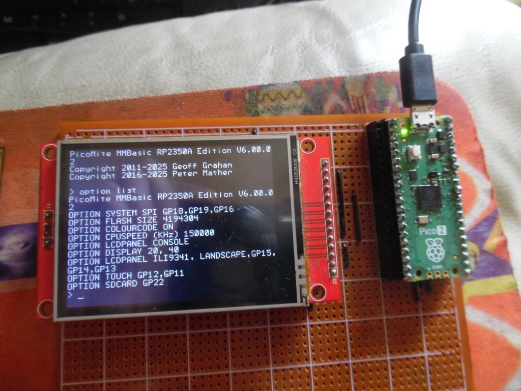

I tried a ili9341 board I built and upgraded to pico2 but no display so upgraded to v6.02 and set options but no display. swapped display, same. reflashed and heartbeat flashing but same. Then I realised I put the pico board wrong way round.
amazed pico not damaged. how to waste hours :)

but rpi pico 2 is forgiving. hdmi took my attention but want to relearn lcd picomite gui cos it's really well implemented with brill features.
not as good as hdmi or vga cos it's spi and slower reading the screen and stuff but still impressive imho

I did a ili bigger display but wired the pico upside down so I could see the gpio labels.2040  silly.
got to wire diode and resistor for it to work touch and sd card which I done but not on above board and it doesn't mess with ili9341

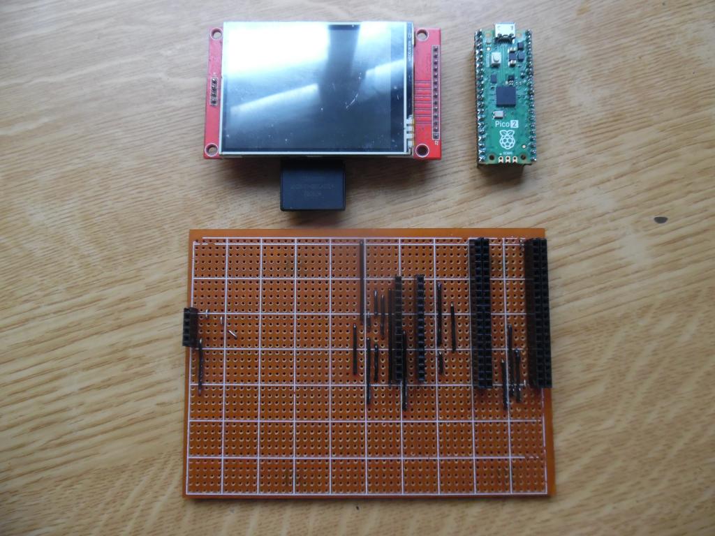

I like you double row sockets for the pico. That saves board estate, and is very easy to implement.

I used 2 20 pin sockets but also used dual 20 pin sockets. 80 solder pins.
I use headers so I can wire under pico but would not solder pico as not easy to remove.
I not pcb user, it strip board, it does work :)
