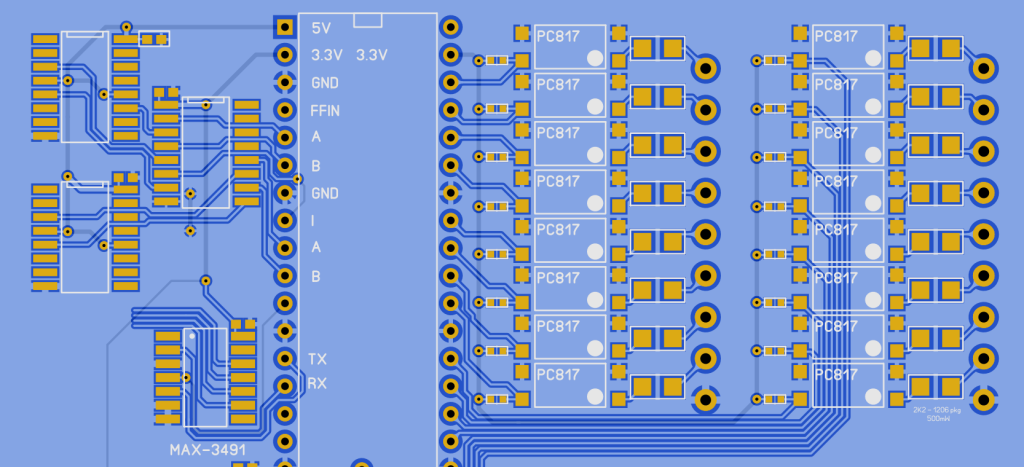

I use optocouplers for 24V inputs from machine sensors.
The unlabeled devices (top left) are for two encoder inputs (I prefer two encoders per axis). They are MC3486 differential line receivers although they can be configured to handle single-ended encoders. The device between those and the RP2350 DIL is a CD4050 for 5V to 3.3V.

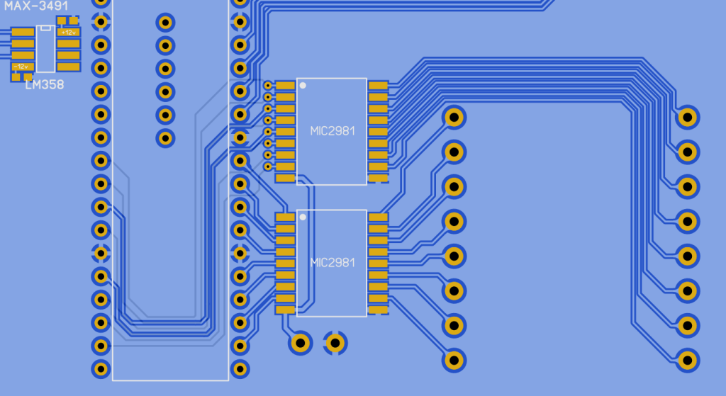

The MIC2981 is used for outputs. The datasheet states that it can be used for stepper-drives. It can handle a decent amount of current although I only use it to give me up to ~30mA per output with negligible load on the RP2350.
The two terminals under the MIC2981s are for external supply (up to 50V?). For me, this is typically 24V although some machines can be 5V or 12V
Bryan, I am happy to share my SL6 files although Matherp has inspired me to go to the dark side (SMD)
My days are filled with running around the country, keeping production lines running and so I don't make the rapid progress that our resident wizards do but I hope to get some done, this weekend.

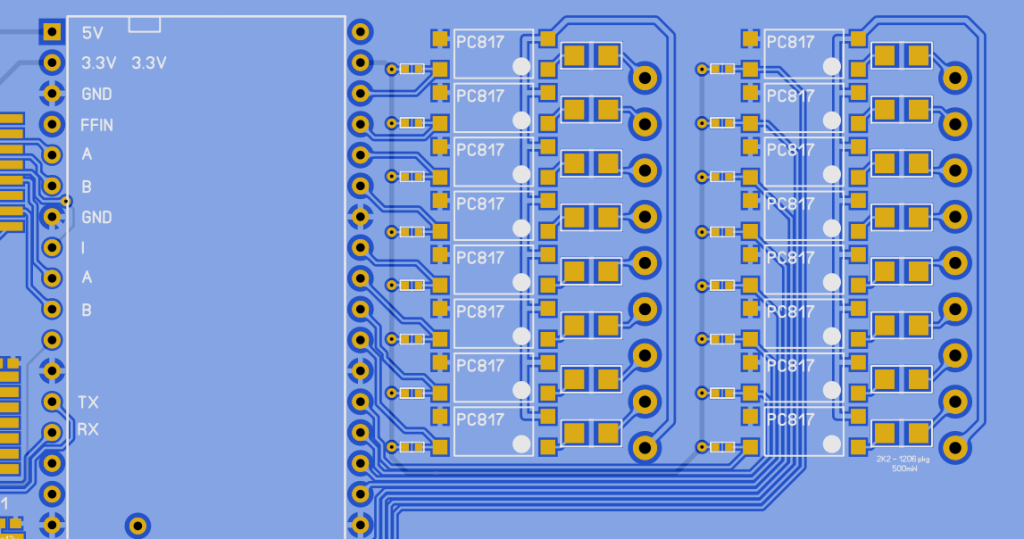

When you have optocouplers at the input, you can also disconnect the LED cathode from your ground plane, and connect it directly to the ground of the system driving the input.
As it is now, the optocoupler shares input and output ground. It does not isolate.
Do you have the 64 pin footprint correct? Maybe the photo is misguiding my eyes, but it feels a bit narrow.
When you plan to use the MIC2981 to drive stepper pulse and direction, you may want to add pull-down resistors from the outputs. The MIB2981 can essentially only pull high. Not pull low. The MIC2981 is a complement to the ULN2803 (that can only pull low, not high).
Edited 2025-07-04 21:32 by Volhout
Not Bryan, but
Hey thanks, Harm
Optocouplers: In fact. What I actually intend to use is the AC-type optocouplers. Yeah I'd better do it now or I'll never do it.
You are absolutely correct (great observation) re: width. Here's where I assumed it was the same as the RPi Pico and didn't measure or check Pete's gerbers.
I toyed with the idea of a pull-down on the MIC2981 but I have thoroughly tested these things with all kinds of loads and haven't seen the need. I will look at it

Corrected DIL spacing and isolated optocouplers.
